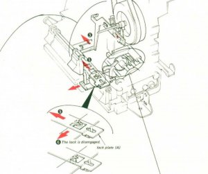

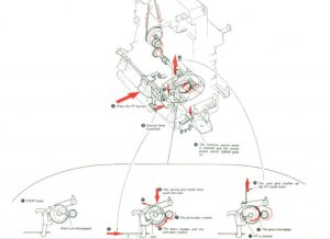

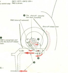

Is the power cord the right one? The in holes on this CFS 99 are closer unlike the regular types. It could be either not getting a good contact or may be not moving the battery/AC switch from battery to AC.
Did you change the belts on this unit? I would change belts and lubricate the push button levers, lock plate etc with light grease and see if it still gets stuck. It appears like some leaf switches are stuck and dirty too. As you know there are several leaf switches and levers activating them. I would take a closer look on the mechanical part and leaf switches.
FF, REW are all activated by cam and gear. Control lever from the front push in to activate the mechanism. Take a look at that cam gear mechanism. It could be stuck in some position on the lock plate even.
I will post a pic of that mechanism soon. It is a complicated mechanism with lots of levers and solenoid assisted shut off.
In my case the lock plate was not working well and lubricating with grease solved the lock up issues.
Other members should know better and can help here...

Wow...good looking out....I like the mechanism illustration.... Thank you...I really appreciate it.

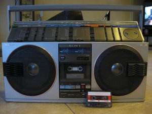

THAFUZZ
Here is a pic of member Fresh Produce's Big Sony CFS-99, with the White Lasonic woofers. I will be doing the same swap with mine soon. image.jpg
These things are HUGE! They don't look like monsters, but they are BIG! Damn near 931 sized, but heavier and more solidly built.
And Fresh Produce's Lasonic Laiden Sony looks like :drool: :drool: :drool:
Boomboxlover48,
Man I could have used those pictures while working on Peter's radio's. Like the pictures show, there is a cam mech on the back of the deck, that when you rotate, it basically resets all the buttons and puts the deck back in NEUTRAL. These are actually easy to rebelt. So if you rebelt it and reset it to neutral, it should fire up and play. Just don't push the buttons while it's powered off after you reset it to neutral.
Rebelt
Reset to neutral
Power up
Push buttons
After that, you should be good to go. (fingers crossed)
I actually needed to Reset it to neutral a few times, but it finally started working.
