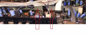

The cutting in and out of the left speaker could be a broken solder point on the back of the plug in the picture. Look on the other side of the pcb to see if one leg has become loose.
I still can't give you a solid lead to fixing the low volume on cassette playback though. Maybe check the plugs that go from the cassette deck into the pcb – or better all plugs –, pull them off and spray them with the contact cleaner. Also look for broken solder joints on the backside of the plugs. But honestly I don't believe that's the solution as both channels are quiet and it is unlikely they both fail from a oxidation. Still worth a try.
atNo worries. I like cleaning and the process of eliminating potential issues to narrow down the causes. I cleaned as many plugs as I could. No changes in the cassette volume output.The connectors, like the one you circled yellow in one picture. Or in the last picture the one with the black and white cable. Sorry for confusing you, I am not a native speaker, haha.
