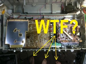

** Tech Update **
My tape deck started to play fast all of a sudden.
I had an idea of what would be the cause so out came the chassis again! :-(
I sprayed the motor pot with switch cleaner and readjusted the speed. All was well for a couple of minutes and then the speed jumped up again!
I sprayed the pot again and adjusted the pot back and forth 20 times to thoroughly clean the contact surfaces.
Adjusted the speed again and it's been fine for the past 10 hrs of playback so I think it's fixed!
That's old electronics for you! :-)
MyOhMy
Well, it looked like a three foot radio to me!
I'll get my coat..................................
oldskool69
Diggin the Sanyo! :thumbsup: And those three feet of yours...I knew there were some strange creatures down under but...does that mean you have three testi... :w00t: :w00t: :w00t: :lol: :lol: :lol:
