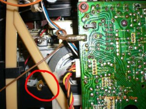

Are you serious? Tuning the speed by the adjusting the friction of the capstan to top bearing? My 70 has a trim pot inside the motor for adjusting.
What are you guys talking about? That plate is for setting backlash/freeplay, not speed. As Michel said, adjust it properly using the motor trimpot. Lets not start doing hack repairs. Overdoing the backlash to slow down the speed introduces load onto the motor which blows regulators and motors.
Beosystem10
True enough, but the VR wouldn't randomly go off value so that, it appears, is how we've suggested that there is more likely to be some mechanical characteristic such as glazed rubbers or even a dry Oillite bush to cause the problem. That VR setting is unlikely to be in need of adjustment where the device has at some time played at the correct speed. :-)
If its going to slow then I usually adjust plate first and if that don't help then I adjust motor speed :hmmm:
Bad Bad Bill
First, the motor mounted pot does often become oxidized and the value can in fact change. Just had that this weekend where the speed on one deck could not be adjusted within range until some deoxit was worked into the pot. These things are 30 years old. In any event, the entire tape transport assembly works together as an assembly. Belt tension, friction in all the rotating assemblies including the pulley's capstan needle, etc, all contribute to the speed. That's why final speed adjustment is performed after everything has been given attention. The motor setting is not intended to stay the same forever. It is intended to compensate for speed variations within that given tape deck. Over time, changes in belt tension and maybe loss of lubrication in some of the bearings, and perhaps some grease getting hard.... makes a difference. You don't compensate for these by cranking down on the flywheel bearing backlash. The backing plate SHOULD be adjusted to the proper amount, but final adjustment should be performed at the motor. If adjustment was performed solely via the backplate, then you could over tighten the nylon bearing and it will soon wear in short order to where speed will once again become an issue again. I don't take issue with all the rest of the suggestions including cleaning pinch roller, etc. I'm only referring to the use of the flywheel backlash adjustment as a means to adjust tape speed -- bad idea.
Remember, these are not complicated motors and the motor speed adjustment circuit is NOT a true dynamic speed regulator that can self compensate for load changes. Regardless of initial setting, changes in load WILL result in different tape speed -- that tiny motor circuit will not self compensate for varying changes, it is intended for setting speed on a stable system.
I agree Norm and read through post again and for some reason I was under impression the speed was slow. I guess I didn't read it right plus I was on some heavy pain killers last week. :lol: but like I said I usually try to adjust plate when speed is slow first then pot on motor :-).
Bad Bad Bill
Actually I was wondering how could JVC design motor speed fine adjustments by using flywheel backlash adjustments. :hmmm: :hmmm: :hmmm:
They didn't! :sadno:
In most sophisticated decks they will give a clearance adjustment of approximately 1mm. That part will have some silicon grease and a teflon stopper mounted on the back plate designed like a cup/cradle for the flywheel axle backlash.
Even Flinstones wont use that for adjusting speed. It is so crude :w00t: :-D :-D :-D Poor motor!
