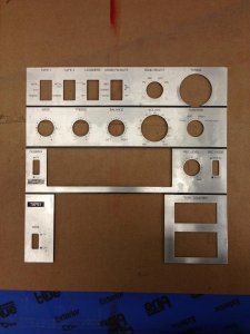

Thanks! Funny you ask about the faceplate, I was actually working on it tonight..Gluecifer said:Man this is gonna rock so hard with all the chrome on there!
Are you keeping the brushed metal finish for all the dial/switch text?
Superb work!!

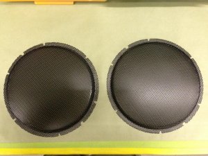

Thanks for doing that research on the amps Freddie! The Lasonic speakers were just an idea, but since I'm doing graff on the grilles the white might not be worth the effort.. I did re-black all the C-100 speakers last night, I think they will be a better background color for the artwork to show more..oldskool69 said:Not disagreeing with what you are saying as we have had this discussion many times before elsewhere on the site. My statement was based on the speaker not being a radical change and my undersatnding of the Conions configuration. Going from 8 down to 4, or 6 to 2 is radical. It has been stated before that there is a given operating range for amp chips and the Conion's chips should be ok from 5.6 to 4.
What one can do, and I highly recommend, is to get into these boomers (if you feel you can) remove those heatsinks and get that old worn out heat transfer paste off the chip and heatsink. I recommend replacing with Ceramique 2 or well rated non conductive thermal transfer paste. I have found out more often than not, failure was due to loss of integrity with the paste and plain old poor contact between the heatsink and chip itself. A reset after 30 years never hurts.![]()

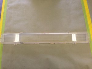

Absolutely!!!hemiguy2006 said:Holy Carp, that tuner lens came out AWESOME!!!!!!!![]()
