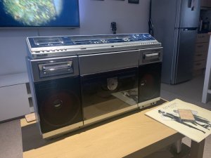

Hi all, I’ve been gifted this beast of a boom box. These are completely new to me and not something I’ve ever really paid much notice to. I think this was made the year I was born and I must admit I think it’s beautiful.
It’s not in bad shape overall for it’s age. Few sliders missing which I’ve already ordered. The case is decent condition and it even came with the box. The internal plastic cassette tray is broken but the cassette still works. The tuner works fine but the record player doesn’t do anything. From the little bit of research I’ve done the rubber belt was prone to perishing with these. Should the stylus still have moved though?

Well after I finished creating this thread ghe postman delivered the turntable belt so I got to work.
Then I had the issue of the cassette tray having a broken tab. Couldn’t find the bit that broke off so I’ve used part of a golf tee. Shame I didn’t have any blue tees though
I’m done for today. Need to figure out how to get the broken bits of slider out of the plastic seatings.
