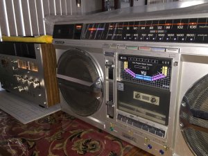

Jap GF9000 (GF535) ... it is fully working but why to wear off the tape mechanism even though it got a new belt and working like new. Using my high end Akai GXC 570D deck...I have 2 of them in mint condition.
That AKAI looks stunning :drool:
