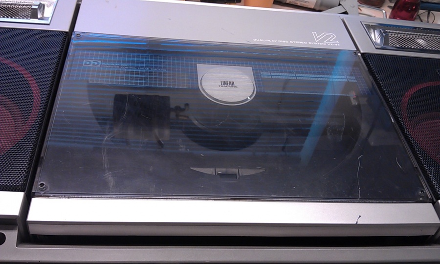

I bought two VZ2000's in Japan and brought them home. One was in very good condition and the other so so :-/

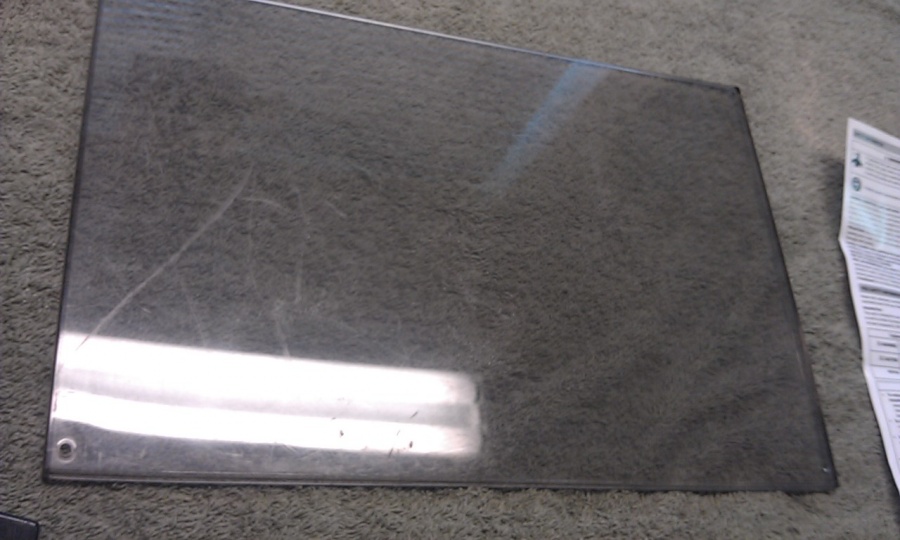

The biggest problem with the one below was it had some GNARLY scratches in the turn table door plastic :thumbsdown:
The thing is, if you carry this radio with the front facing your leg, it's going to get scratched, there is just no way around it. This means the vast majority of these radio's is going to have scratches in them.
It's hard to tell from this picture, but there are some nasty scratches in the front....
So, I have a kit that is used for cleaning and brightening yellowed headlights on your car made by 3M.
Here is the plastic I started with.... :thumbsdown:

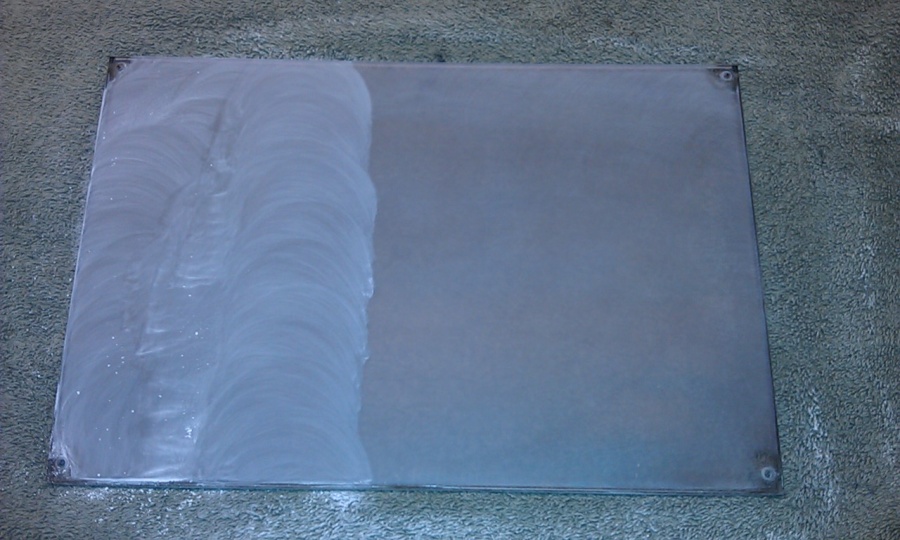

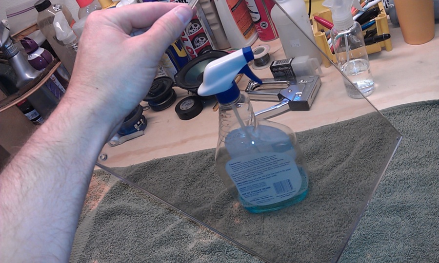

These kits are easy to use, you start out with an abrasive and work your way across the surface.
Each pad uses finer and finer sand paper....
The first sanding removes the big scratches....

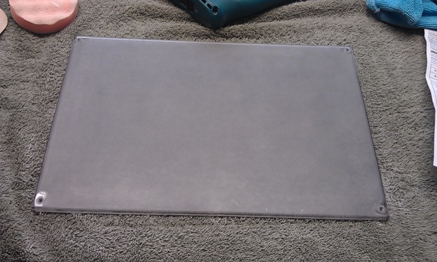

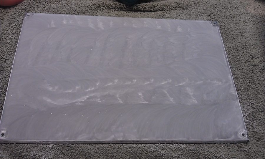

The next one smooths it more....you can see it's still hazy, but no scratches.

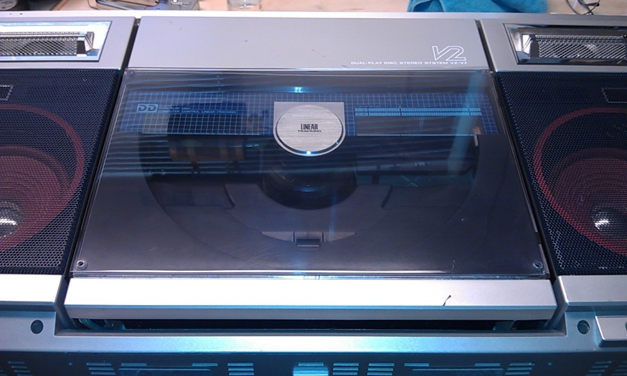

Then after the final polishing with the pad and cream....It looks really good. I even did the inside with just the polishing cream. It really made it clear. :thumbsup:

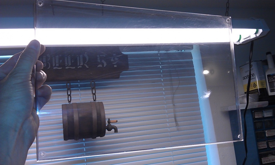

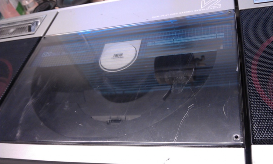

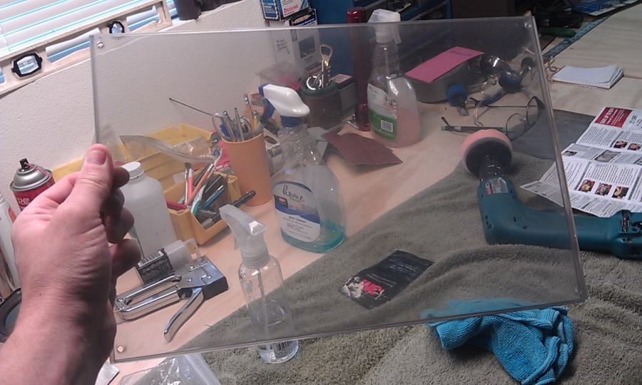

Today I have done the second front plastic from the other VZ. Since I have done this once before, I have gotten a little better at it and this one is a clear piece of glass now!
It started out much like the other one....HAMMERED...
Sadly, I have avoided VZ's in the past that had scratches just like this on them because I didn't think I could fix it or find a new front piece.
Once again, going through the process.
All in all...it probably took me 40 minutes to do this....which isn't that made. If you consider it this way, if you spend $1,000 for a pristine VZ2000 to avoid bad paint and scratched plastic or pick up a slightly less "Ascetically Pleasing" one and do these types of repairs...you save your self BIG money.

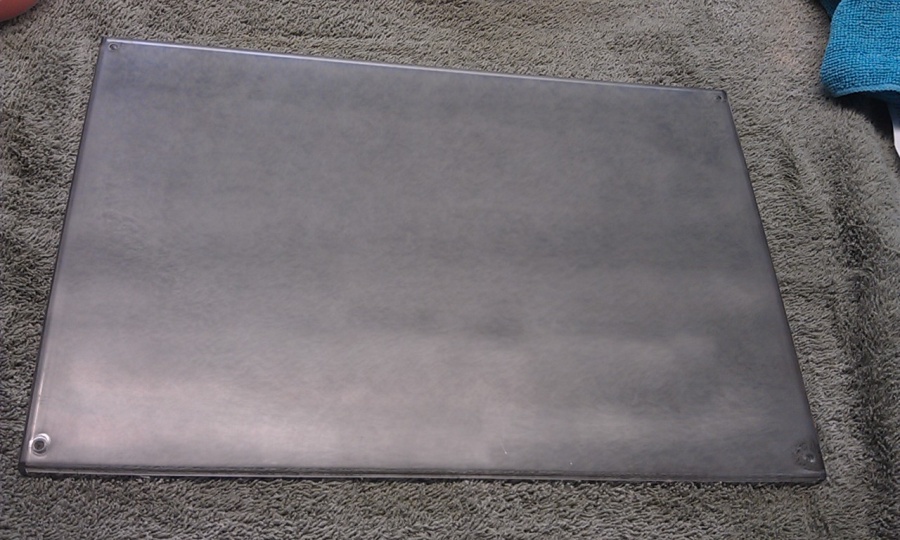

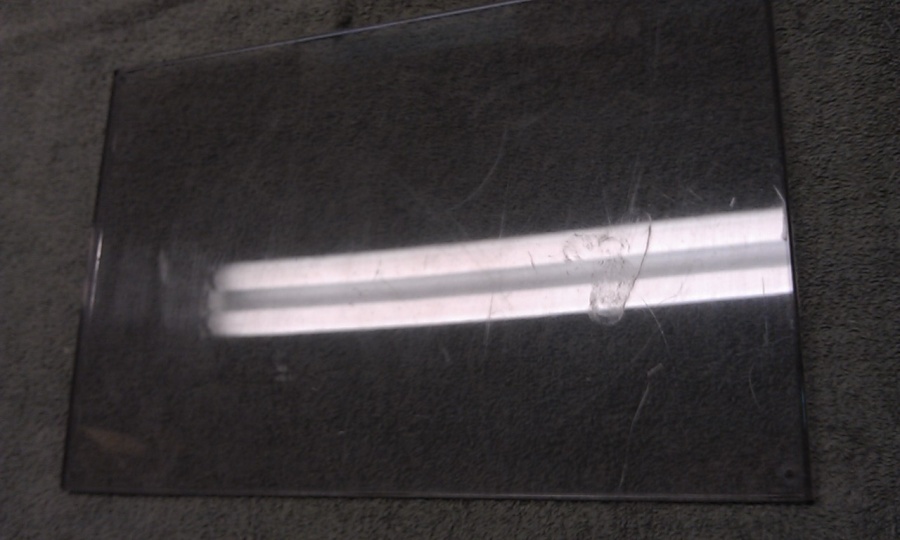

You can see here it's coming along. It still has some hazing from the sanding....So...a few more minutes with the polishing pad and polishing compound.
Now you can see that is pure glass :thumbsup:
So, here is what I have learned....
When you buy a headlight lens cleaning kit follow all the directions....OH and practice first on the car!
The kit I have could easily do 3-4 cars worth of headlights, so I still have plenty of sanding paper and polish left over.
MOST IMPORTANT!
DO NOT USE A HIGH SPEED DRILL. This will burn / melt the plastic and then your :'-(
I used a cordless, low speed drill and very light pressure. I was very patient and took my time.
I did have to go back a few times to work out scratches that I could not see until the last process. I also had to do the inside of the panel to make it REALLY nice.
In the end....anyone can do this....I know all you VZ guys probably have some level of markings so get out there and get'em polished up! :-D

24
38
very nice chris.....i use a makita 7" high speed polisher with a wool finishing pad....with some 3m microfinishing compound ...then use 3m finnesseit..plastic come out like brand new.. :thumbsup: :thumbsup: :thumbsup:

very nice chris.....i use a makita 7" high speed polisher with a wool finishing pad....with some 3m microfinishing compound ...then use 3m finnesseit..plastic come out like brand new.. :thumbsup: :thumbsup: :thumbsup: http://i1194.photobucket.com/albums/aa373/bklynvettepics/b997a1cf.jpg
Giant Tool, Little Plexi...but yes, same idea. :-D
