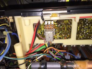

I am doubtful the power switch is working okay. When I press it is not turning on anything. When I release it doesn't make any difference.
The rotary fader control is on the top and a switch at the bottom in that metal box enclosure.
I was wondering if anyone opened and work on it.
