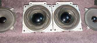

I scooped up a local sale on FB & got lucky with this Panny DT-75, Cobra-Top. I got both decks going after blowing the dust off the cassette feeler switches. They work great, including music search & sound great too. Very close to CD quality. The CD, Line-In & Radio all perform flawlessly & without any issues. I pulled it apart to see if it had the dreaded woofer rot that so many people complain about.
As you can see in the photo, when I got it I saw this through the grill & had to investigate further. The bottom of both woofers(L&R) looked like it had separated the surround along the bottom of each. These woofers are funky with their folded surrounds. They play with the light behind the grill , so it's hard to know what your looking at.
To my ears, the speakers sounded quite good anyways & did not hear any noises, buzzes, rubbing voice-coils, flapping or hashness of any kind. I bought it on the spot because my Scorpions CD & 2 mix tapes I tried sounded excellent, with clarity & a balanced Hi-Fi sound. It's rare to find a fully working unit, with remote. It's in great shape too,

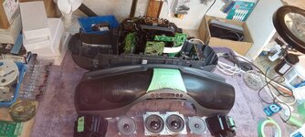

When I pulked the front off & removed the drivers, I realized I hit the 'Panny Lottery' with this one. The speakers were dusty but all drivers are intact & in perfect shape too.
I got the front off & washed the entire molded half-shell, including the grills, with mild soap & warm water, I'm waiting for it to dry completely before reassembling the Cobra.

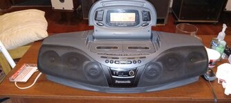

Panasonic RX-DT95 is very much like the RX-DT 75. If disassembly is easy, I will attempt it one of these days. Thanks!
Not my pic! Found this pic from Ebay!
My pic below:
