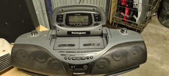

I do love a Cobra top! I think I have 3 or 4 now, including a modded DT-75 by Portogram, so you can vary the speed of both cassette decks and the cd player. I think my cassette decks need some love, but I don't think I paid too much for it either!

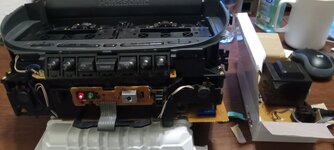

Ok. I got the chassis sitting on my coffee table & running Win10 & WFGUI. I got a decent result on both decks with speeds within 5-8Hz of 3000Hz & including both directions of play on both decks. As pictured below, I have the power block sitting in a cardboard box, to the right side of the photo. It's feeding the guts, left of center. I'm using cardboard & a white plastic tray from the grocery store which is thick & hard to puncture, as a riser so the CD ssembly can rest below it without having to yank apart the ribbon cable that connects them.

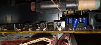

In order to adjust the speeds of the tape decks I downloaded this manual & looked up the layout of the tape speed contrtols. They are not on the tape motors, as it would be cubersome to take apart the entire chassis to service the decks in a routine manner. Instead, Panasonic decide to create an adjustment circuit, separate from the motors & accesible when the chassis is removed from the cabinet. The speed adjusters are accessible from the rear of the chassin & use a jewellers philips screwdriver to properly operate them without undue torque or stress. on the delicate controls.
The adjusters for both decks are deep in the guts of the main chassis, behind the AM ferrite antenna of the radio circuit. You can barely see them if you look behind the iron bar & back a ways & slightly out of focus. They are the 3 white circles, with slots in them, visible just under the grey bar, at the top of the photo below.

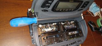

The problem is that you cannot use a normal philips jeweller's screwdriver because they are not long enough to reach the adjusters, by a couple of inches. Luckily, I have just the screwdriver for it. My 2' long jeweller's Philips head. BAM!!

I was wondering why there are 3 trimmers for adjusting two motor speeds!
The outer adjusters are for each deck's separate speed. When looking at them from the rear of the chassis, the right adjuster is for Tape 1 & the left adjuster is for Tape 2. The middle one adjusts the speed for tape 2 while in Hi-Speed Dubbing mode, so that both tape speeds can be sync'd when using that feature. I didn't mess with the middle setting since I don't have the proper equipment to make a proper adjustment.
