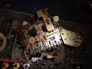

Pause issue is most likely the old grease has almost hardened and needs to be fully cleaned with rubbing alcohol and fresh grease applied. To do this you must take deck out and may need to remove some parts to get under the pause mech. I actually had to do this with the GE 5286 that Chris now owns. As for power switch you might be able to get off of another parts unit. Not sure why but the GE/Realistic models both have these 2 issues always. By parts unit you may be able to use a different box with same switch style as many manufacturers used same parts. I've used many switches off of many different units but they are all same. As long as it has same throw and same amount of legs it will work. Good luck

I'll just use the Realistic to figure out where that goes.
