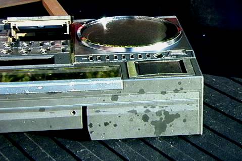

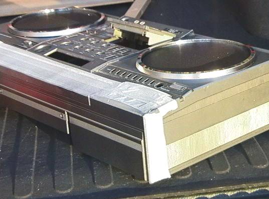

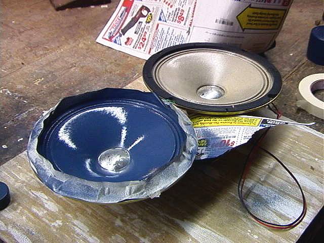

so - its good to have the right colors in stock -
thanks to melly -- here is the case paint code =
duplicolor T-183
and thanks to ford --
the speaker can is duplicolor fabric ==medium blue # HVP 112
plus the duplicolor clear top coat
my top panel now looks like brand new-
and so do my woofs :thumbsup: :yes:
on a side note --i am tending to agree with the few here that have posted
that an OEM woofer color was TAN --
because this set of speakers did not look at all dirty or faded to me --(just dusty)
i painted them only because i think the blue looks better --
seen thru the grills
now i have one question............
anybody here know how to re-paint the DELICATE center caps-
to original shiny chrome ???
PLEASE :angelic: :angelic:

i tried to use an ultra-lite spray coat on both blue and on the top coat --
have not tested them yet --
but ford used these exact products , and his m90 sounds NEW !!
update -
-as per :super: advice --i used duplicolor CHROME to
re-do both center caps this morning --
as he pre-warned its NOT like real super-shiny chrome --
but 90% ok --
and as my caps were fubar anyway --it was well worth the chance-
now they look much much better
