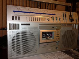

One switch cover for any of the function or stereo mono or normal/metal/CrO2 selection and new antennas will make it mint.
It looks like new and the inside also smells like new. :-) :yes:

M80 is different, it is unique and a beautiful box to have with lots of good features. :dj-party: The more I use it I love it! Mine is in fantastic condition! I need one switch cover and antennas.
If they only went with round metal grills I would invest in one. Not to fond of grills on them :-(. I'm sure it's a well built unit though. Enjoy it Royce ;-)

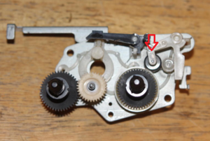

Some tapes behave just fine, but others barely rewind, and the play heads come right back down. I have this same issue on my C100F, could this be a bad idler? How can some tapes work fine and some barely/not at all?

Eric, I was going nuts..
There is an inner idler wheel that cause all kinds of problems.
We have to replace that rubber.
caution said:
Put the new belts in last night. I noticed that the original 4.6" belt is actually orbicular, and the grooves were correct for it. It was in good shape so I left it in.
The inner idler wheel is the root cause............
Our buddy superlew (Aram) came to the pic and educated me on it...if not because of him...I would have never fixed the deck.
See that trouble maker.....
Thanks to Aram... (superlew)
Aram....is the deck expert here on Boomboxery! He is Awesome!

Rats! I wonder if belt dressing or something along those lines could coat the rubber to restore it to a good surface. To rebuild it, and take the deck all the way apart to replace it has a pretty low return on investment, i.e. just can't play some tapes on that deck.
