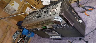

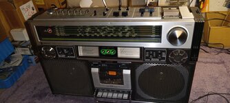

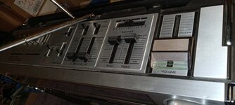

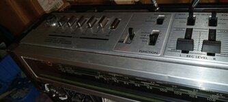

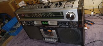

The next on the list to get the cassette & FM Stereo calibration is the JVC RC-838JW. It is very close to mint except for a couple of small dings in the metal trim around the top controls & tuner window. It is now in excellent fully working condition & looking good with a LED mod for the tuner dial & VU meters.
I had to tweak the 19Khz & separation variable resistors to get stations in stereo again & used my trusty 3000Hz test tape to dial in speed & azimuth(head alignment).
Check it out!
