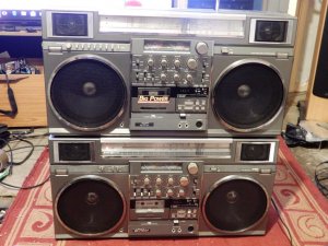

JVC M90 Tape deck brakes don't disengage, fwd/rwd/play all don't work

If it's the same problem as mine had, you want to look at the eject slider. The picture here highlights the slider. Mine is a little bent here, it should be straight on the right hand side:
Caution described how this slider needs to be able to move left/right. Mine was stuck and didn't move at all, which caused it to stay in the 'eject' mode which will prevent it from playing. You can easily take the deck out of the boombox by removing 4 screws, disconnecting a few connectors, and lifting it out. Then you can access this side and see if that slider easily moves left/right. If you want to try this and need the location of the 4 screws let me know and I'll post a picture w/more details.

Ok straglus, thanks to you're very helpful post this might be the issue, as that slider seems to be sticking but not bent, you can lube this slider at the back of the deck. iv lubed it and im waiting for it to dry (not wd40 haha....if this works i will flipping marry you haha, fingers crossed :thumbsup:

na don't want to marry anyone to good being single and i bat for the girls haha least i did before old age haha...my victor was total scrap tbh it took me and my engineer 3 years bud and thats without a recap...but she has been working fine for the last year until now...machine oil sewing oil is good imho but you need to check with others first because there is probably much better...that bar that was sticking there was actually a head wire jammed against it, id never noticed that bar until you're post as im partially blind...but i will test her in about an hour and report back....the thing is we have put so much work into this one but at what point do you stop ehh...as you may have noticed mine was up for trade briefly but i just can't lol

It's working but we will see for how long lol.....100% it's the bar though. so im not worried now, thanks everyone, you guys rock :thumbsup: :clap:

least i put us on the right track in the first place strangulus lol two happy campers, the victor is playing now :thumbsup: thanks to you're post, i wouldn't have noticed but you marked it in red which i could see :lol:
