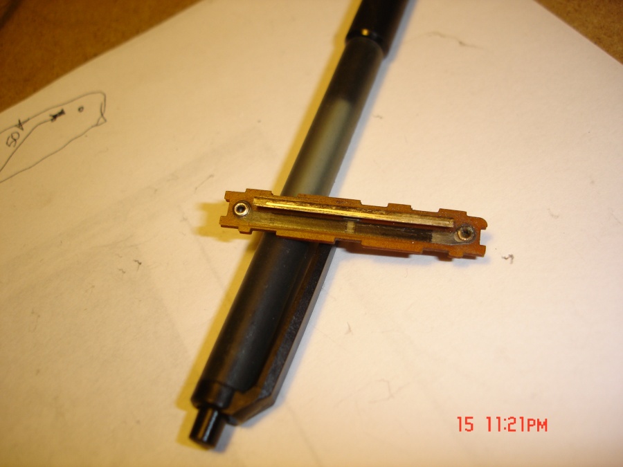

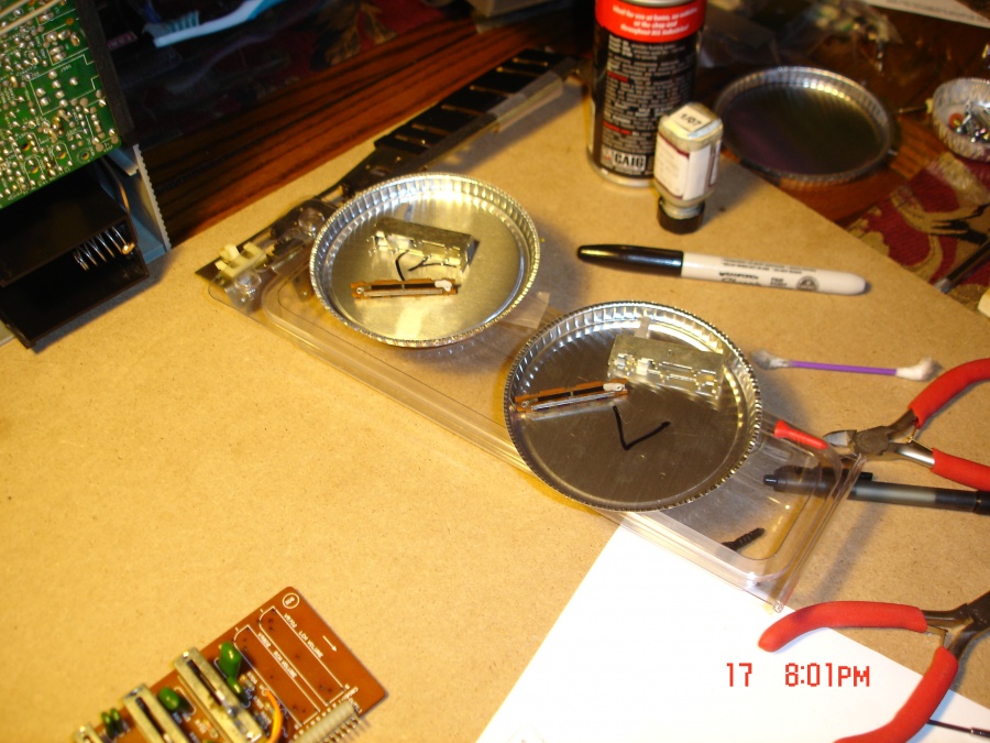

I forgot to add some pictures where I used the conductive paint on the carbon resistor strips. You can see the white paint at the end of strips where it had the breaks.
