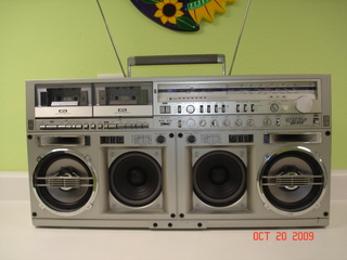

I have to just say it.
Just looking at the 777, you can tell it's wack :lol:
I mean, the woofers and subwoofers are the same size. :huh:
The subs should be bigger.
And in fact, you really only need one sub anyway (like how the Big Ben does it).
The only reason Sharp designed it like that was for looks.

Hmmmm well I felt the same way about the 777 as some of you guys did. I didn't like the woofers in the SHARP but, I really like the speakers that Lasonic's have. Especially from my L30's. So I combined the two together. I bought some Lasonic woofers and put them in my Graffiti'd 777. When I turned it on I was beaten over the head with some serious BASS! (x4!) The radio changed completely. Now it looked the way it sounded!! Awesome. Anybody with a beater 777 go ahead and give it a shot. You'll see what I'm saying. Same specs and all that. The air these speakers move is amazing. Anybody with some laying around please reach out to me cause I'll take them. Especially the white ones. It's like they're meant to be placed in these SHARPS.

Technically, there are no "subwoofers" in ANY old school box, just woofers and mid-bass drivers
(which the 777 has both of) 'cause none of 'em are hitting below 20Hz.
Also, two 6" drivers have more surface area than one 8" driver and can push more air...
That said, the problem with the 777 is the same problem with all Sharp boxes: light on bass 'cause their woofers aren't designed to go low.
If these boxes came with Lasonic or Toshiba-like woofers, there'd be MASSIVE improvement that would probably blow a Big Ben out the water!

3 things, Joe.
1. Replace the tweeters. I used titanium-domed bullet tweeters from MCM electronics.
2. Replace the super woofers. I got some from MCM that are good down to 38 hz. They clean that muddy lower end up cleaner than a just changed baby's bottom.
3. Yeah, that's right, replace the outer speakers... with co-axial automotive speakers. Mine are Pioneer. Extra tweeters! :w00t: Woo Hoo!
Link to the project seems to have gone missing over at S2G. I'll try and find a picture. :hmmm:
It's a quick swap. I saved my originals to swap back. :yes:
