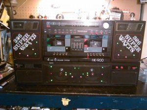

Hi everyone, received this guy from a member here -in a different post a few days ago commented on manufacturing new doors for it -the post is gone? Anyways, it was missing both bottom compartment doors - after some hours and fun with Dr. Suess pipework

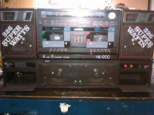

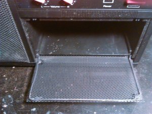

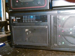

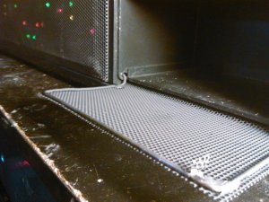

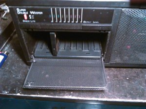

Here are some pics of the reconstruction of them. Used a donor Sanyo 3 piecer , took grilles off , etched with a utility knife to break the edges neatly , used a metal coat hanger for the frames , then sanded inside the grilles and the coat hanger and soldered from the inside. Notice on 1 pic there is a small tab of grille material standing up - that is what keeps the door closed .
Next part will be to stencil the name and the model number on each door..
Here are some pics of the reconstruction of them. Used a donor Sanyo 3 piecer , took grilles off , etched with a utility knife to break the edges neatly , used a metal coat hanger for the frames , then sanded inside the grilles and the coat hanger and soldered from the inside. Notice on 1 pic there is a small tab of grille material standing up - that is what keeps the door closed .Next part will be to stencil the name and the model number on each door..
