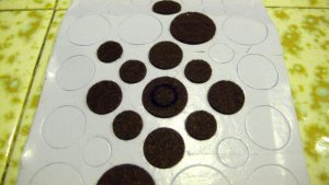

Using old-school drafting template to mark area to be removed
Marked pad on card

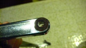

Finished pad stuck to right side of handle (another finished pad was attached to left side before re-assembly)
45° angle FTW (handle is not resting on the antenna)!
45° angle FTW (see)!
Marked pad on card
