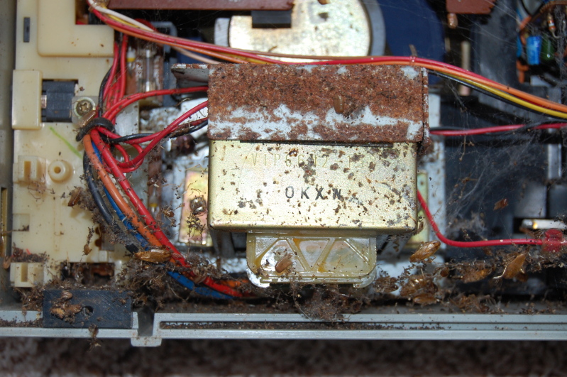

I will tear boxes down, rebuild decks, hammer out speaker grills and polish dial plexi, BUT I WILL NOT mess with a tuner string :no: NO WAY< won't do it.... :nonono:
I would lick the transformer first :lol: :hmmm: :thumbsdown:
:agree: that is some job there jeff ....I commend your bravery :thumbsup: :thumbsup: :thumbsup:
OK
(you might want to reconsider :lol: )
