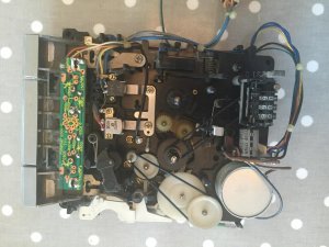

Out she comes.
I notice the 2 smaller belts are slightly different lengths. Which goes where?

Nevermimd, I figured it out. I've replaced the belts, cleaned up the flywheel post and added the new rubber tubing. I'm almost done re-assembling it, but I've noticed this issue with the casing. The bottom corner screw hole is broken, so the screw won't turn at all. Is there any fix for this?

Broken screw posts are really more of a restoration item than a tech item. Several members have repaired broken posts using various methods. Search for "screw post" in the Restoration section. ;-)
hopey
I have worked on a couple of these Boxes. Another problem can be the fast forward and rew functions. The tolerances are super fine and finding replacements aren't an option. I use a fine grade sand paper to re face the rubber pinion one on the front which runs off the capsan pin. The other on the back which runs off the flywheel. The spring on the capsan roller looses pressure so give that a tweak also.
