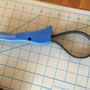

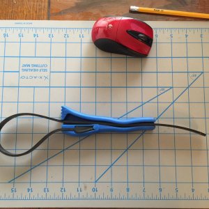

Another tool I really like is the Craftsman bottle opener.
The rubber on it easily grabs on the knobs and we can pull it if there is enough surface area on the knob to grab on with it.
I mostly use this rubber and wrap on the knob to pull them out. Works with less effort.

BoomboxLover48 said:
:-D :-D Save those pretty nails sister!
Yep, I have one of those handy tools and....................a pair of rubber(ised) washing up gloves - excellent traction. :yes:
