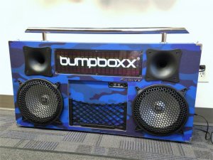

It sounds like the tuner has poor sensitivity, and even poorer selectivity and no muting to speak of. Both of the previous are important tuner performance specifications and as you have experienced, even old school tuners are decent, with muting included with most stereo tuners. The muting function basically is a tuning strength threshold that allows only the strong (actual) stations to come through and blanks out the static or poor stations. Generally speaking, the cheapest boomboxes will have a tuner that has acceptable tuner performance while higher end boomboxes "should" have stronger tuners that have better sensitivity and selectivity, with the best performance from standalone tuners, or higher end SW type of radios.blu_fuz said:FM tuner is no better than the last ones. It scanned and saved 30 stations and only 1 didn't have pure static. Why are these stopping on static and saving the preset station as if it actually had a clear signal???? ................. How do my digital and analog blasters pickup 20 clear stations and this doesn't?
I was hoping against logic that the tuner would actually work on your V3.0 box Joe. This situation sucks. :-(blu_fuz said:FM tuner is no better than the last ones. It scanned and saved 30 stations and only 1 didn't have pure static. Why are these stopping on static and saving the preset station as if it actually had a clear signal???? Really there were 2 main reasons I wanted the V3 and sold my SE:

Superduper said:It sounds like the tuner has poor sensitivity, and even poorer selectivity and no muting to speak of. Both of the previous are important tuner performance specifications and as you have experienced, even old school tuners are decent, with muting included with most stereo tuners. The muting function basically is a tuning strength threshold that allows only the strong (actual) stations to come through and blanks out the static or poor stations. Generally speaking, the cheapest boomboxes will have a tuner that has acceptable tuner performance while higher end boomboxes "should" have stronger tuners that have better sensitivity and selectivity, with the best performance from standalone tuners, or higher end SW type of radios.FM tuner is no better than the last ones. It scanned and saved 30 stations and only 1 didn't have pure static. Why are these stopping on static and saving the preset station as if it actually had a clear signal???? ................. How do my digital and analog blasters pickup 20 clear stations and this doesn't?
I suspect that on the bumpboxx, the tuner is an afterthought and likely the exact same design as the previous design. Since there's no question in my mind that the bumpboxx is not a custom designed product in terms of circuitry that was commissioned to be built/manufactured in China, but rather a combination of already designed "modules" incorporated into the product, it's no big suprise that the tuner probably is no more feature rich than ones like the following:
[ebay]222497695518[/ebay]
There are others but I suspect that they are all very similar in terms of design and performance, and I suspect that a similar circuit is probably incorporated into the bumpboxx as well. Of course I'm just guessing but it would be interesting to take a look at the actual bumpboxx circuit board and have a look-see.
I forwarded the above conversation to Rob of Bumpboxxjimmyjimmy19702010 said:I was hoping against logic that the tuner would actually work on your V3.0 box Joe. This situation sucks. :-(FM tuner is no better than the last ones. It scanned and saved 30 stations and only 1 didn't have pure static. Why are these stopping on static and saving the preset station as if it actually had a clear signal???? Really there were 2 main reasons I wanted the V3 and sold my SE:
#1 tuners were supposed to be fixed
#2 my lime green SE was broken more than it worked
Fingers crossed the rest holds together. How do my digital and analog blasters pickup 20 clear stations and this doesn't?
