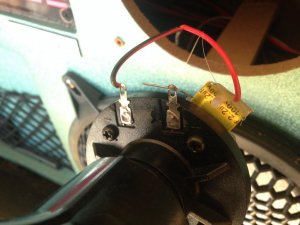

Anyone else's tweeters start clipping at 60-75% volume on bluetooth?

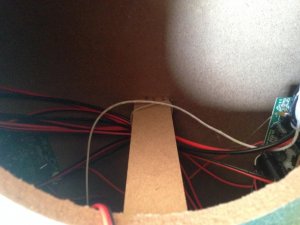

I don't own a Bumpboxx but I did get a chance to hear two of them at the last Venice meet. The two that were there could not pick up any FM signals. Chris was playing music through a very high powered FM transmitter (with a 5 mile radius) located in his car about 25 away. All the classic radio where picking up his signal but neither Bumpboxx could!

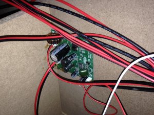

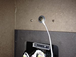

I believe someone fixed that. The antenna wire was not connected to the speaker basket like it should have been.
The FM tuner is poor on those things - (from all the reports from owners). Having a wire antenna that sits inside a wooden box full of electronics and magnets wouldn't be doing the tuner any favours.
I read somewhere where someone was going to install a proper external telescopic boombox antenna to improve things.
I will have to do something with the FM for sure. Also, there is only an auto search for the stations that only starts at the beginning of the tuner scale every time you push the search button. No way to manually tune to any station you want.

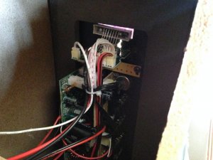

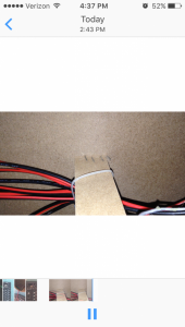

Moved the antenna wire and mounted it to the handle bolt. This allowed for the scan to lock 30 stations but they are all inaudible static :-(.

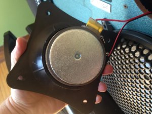

Joe those tweeters look like they have interchangeable lenses which means you can unscrew the Tweeter base from the lens and then put it on a different one.

Joe that antenna wire is way too short .I would add an external antenna or extend the antenna wire,preferably something outside the box because the mdf is probably blocking the signal.
