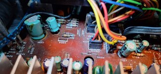

Picked up a C100. Dead on arrival. Found blown fuse wrapped in Double Mint foil. Swapped the fuse and lights up, cassette motors him but no radio, alarm and no working headphones.
Took a closer look and there's a chip completely missing inside. (Pic attached) Q204 has left the building. Anyone have a source or link where to buy 1?
Wonder why it's gone? I'll need to add a new 1 and see what is still working after. If only this could be bypassed just for testing..

Saw this earlier just need to know where to find a replacement.

Q204 is a 2SD325, they're widely available. I mis-spoke in that comment - D202 and Q204 seem to work together as a regulator for powering everything except the alarm, amp chips and deck 1 motor/LEDs (the alarm button actually cuts power to Q204)
RaleighRon
Awesome thanks man. Hoping that's all that's wrong with it
