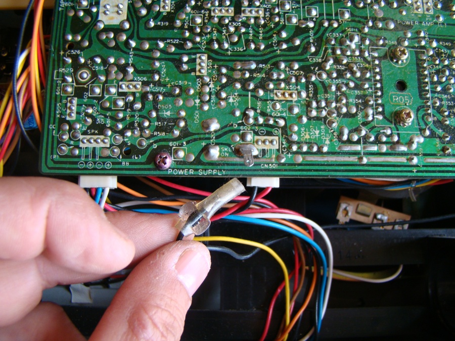

Today open for firts time my m70 ,to try to fix the bateries problem , and for my happiness ,is only a disconected wire!!!!
plug again and problem fixed!! :-) Now is ready for the streets!! ,
only I have to change the belts to be 100% working

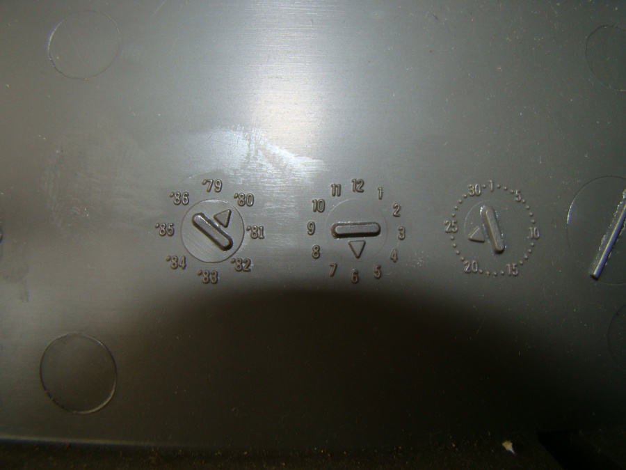

Nice fix, but I LOVE the date code picture. June 23, 1980, is your M70's birthday.

good you fixed :thumbsup: :thumbsup: :thumbsup: it but make sure you crimp it a bit because if it came out one time it may come back out again with use unless u make sure its nice and tight on the connection :yes: :yes: :yes: :yes:

thank you all for the comments, really happy with the easy solution!!
my knowledge of electronics are very close to 0 :lol: :lol: but I try to investigate, more curious that a small cat.
