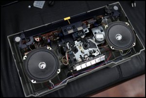

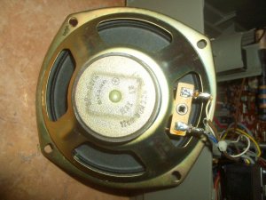

Hi,
I have been trying to figure out where to get replacement speakers for my Sharp, well brand is not so important as this is just generally speaking.
At radiomuseum the speakers for the sharp GF-5757 are stated as being:
Ø 12 cm = 4.7 inch
Power out
9.6 W (unknown quality)
120mm = 4,72"
The amp IC is 4 Ohm
I really have no idea where to find a 4,7" speaker unit in europe.
I am guessing something like this would work? What do you think?
https://www.hifisound.de/en/Do-it-yourself-Products/Speaker-Drivers/Fullrange/Fostex-FE-126-En-Fullrange.html
Datasheet:
https://www.hifisound.de/out/media/pdf.php?r=JmWNZ9RsVBqS%2FIG7lwzNFjdp2Z9zYzTQgUkQ6Riv4jjZs7o%2BMCiVXboZGzzz14xvBf7q5LizLYG0E0oA4Ky51Q%3D%3D.pdf
I know that the magnet size will maybe be deeper but It wont be a problem.
Only problem is that the impedance is not matching i.e. the speaker i linked to is 8 ohm and the amp is 4.
I was thinking that this thread could be a good reference for finding replacement speakers.
