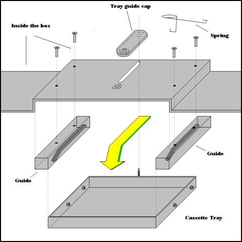

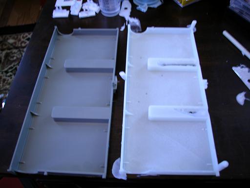

I made my own hacky drawer, it wasn't hard, but I added a metal plate to the base of my unit to protect it, I'm sure this is the design flaw in the original, where the unit has been place on uneven ground with the entire weight of the radio being place on the flimsy drawer. So the metal plate on mine has protect it nicely, it just slides in and out though, no spring action.
However, I do have saved images from someone (forgive me for not remembering their name) who posted on s2go a while back who was going to make some up from a mould and casting them up. These may help:
All credit to the parties responsible for posting those images originally.
That's what I'm talking about!!! That's a nice way of setting it up!! Maybe bredgeo can make it? Gotta ask him!
Yeah, bredgeo might be the man for the job!
I was going to make an all pre-finished galvanized steel drawer. Like GLU said, I want it to withstand setting the weight of the boombox on it in case you are on uneven ground.
I will see what I can come up with, GLU - those pics of the repo someone did look like it would have worked nice.....
