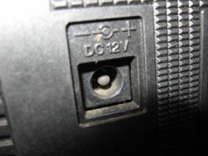

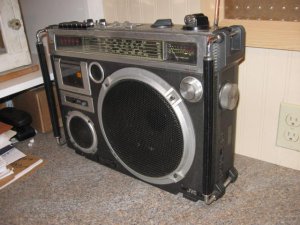

Hi. This is my first post ever. I bought a RC-550 and I need a power supply cord for it. It says "DC-12V". Here is a photo. Is this something I can find somewhere? Thanks if someone can help. It's working off of the eight D-Cells right now.

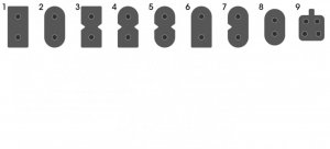

#5 is what I selected and it will fit most of our boxes except Sony CFS 99 etc.
Those V shaped cuts on either side ( the gap on the top is close) should lift the battery cut off switch also.
I had luck with those types for many boomboxes.

Thank you. Ordered. This won't be my only question, ha ha. Appreciate this resource.
Can you measure the distance between the two pins on your box? These old boxes have pins closer together and not compatible with new cables.

New ones are 8.5mm if you try to use you will be bending the pins in the box.
This is the correct one although very hard to find. The pins are 7mm apart old shavers have this plug as well. jvc plug.JPG

Received the cord that I had ordered and the measurement confirms the slight differences discussed above. I warmed the radio a bit near a space heater and then inserted a needle-nosed pliers in between the pins to widen them a little. I inserted the cord with no problem and the radio sounds fine (batteries out). So I appreciate both responses; the practical one and the technically correct one. I'll post another question soon....I need to open it up.

That 0.75 mm clearance on either side of the holes make no difference at all to fit in. The female pins will easily wiggle/jiggle and accommodate in the plastic holder of the plug. :-D
Dec 3, 2010
5,763
276
Chicago, IL
Why would you this is a so called Grail?
Because nothing will happen to the pins at all!
There is good tolerance.
It is not special like the pins of Sony CFS 99.
Most of all JVC AC cords for M90, M70 etc. will suit RC550.
JVC RC550 cord is not anything very special!
There is no need for overengineering!
