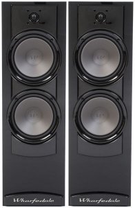

Wharfedale AT-400 speakers - 4 x 8" 150W with 2 x tweeters
All the Wharfedale speaker bits including the crossovers, bass ports, sound foam etc.

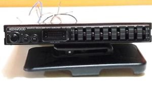

Kenwood KAC-642 amp - 4 channel, 160W
Kenwood KGC-4032 EQ and amp - 40 + 40W

Using existing, professionally designed speaker cabinets - drivers / tweeters / crossovers and replicating the cabinets volume and bass ports sure makes the whole process much simpler and predictable.
Most project builders really can’t be sure how the speakers, crossovers and cabinets they have chosen separately are going to sound together until after completion of the build.
For my V5.0 build, I looked long and hard to find 2 way floor standers with 8 inch woofers, silk dome tweeters with between 4-6 ohms and high sensitivity - never found anything at the right price so I started from scratch. The only items that were designed to go together were the Krix tweeters and Krix crossovers that we’re designed to suit 8 inch woofers.

Awesome, if you want to trade that eq I have a Kenwood 9044 digital DSP crossover with sub output.
Sorry, hanging on to this one. Aim is to maybe have it under the iPad mini so it represents the control buttons under a tape deck.... that's the idea anyway.

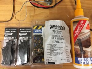

Next steps were to get some wood and fasteners. Off to the local Bunnings. Receipt and pix for any that want more reference on the build parts:

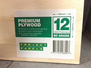

4 x 1200x596x12mm BC Plywood sheets
2 x 2400x42x19mm pine runners to use as cleats and strengthening
2 x packs of countersunk black screws for outside cab
1 x pack of button tops for inside the cab
1 x Sikabond PVA glue
Next steps are to mark out the wood, cut, and start building the box.

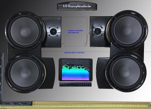

Ok, here's the mockup. I'm thinking I will trim the height a little and probably not use the plastic that sits between each speaker. I'm looking to cover the front panel in a purple carbon fibre which will hopefully set off the black and grey of the other parts. I'm sure I will change my mind every day until I am ready to wrap it.

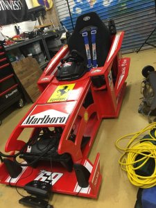

Thanks Northerner. Here's a another shot of it from the front. I made this one out of MDF with 2 hardwood skids (took 3 people to lift it), genuine car seat, race harness, 5.1 sound. It was great fun but I rarely used it and moved it on to a young whipper snapper. Painted it in 2 pac and despite putting up plastic drop sheets and sealing the painting area I still had a red mist and dusting throughout the man cave that took months to get rid of. :thumbsdown:

It's probably me just being nitpicky, but I would move the tweeters to the outside in a small attempt to increase what stereo separation there might be. However, if you are going to mono the box, I don't guess it really matters.
I agree
I would also add a vertical internal split, to provide better separation between the left and right channels. In fact most people use 2 vertical splits, to create a separate compartment for the electronics and battery.
I'll give you credit , you don't think small lol.
That actually reminds me of some of the old school car stereo display stands.
So by having the boombox split horizontally (internally), you’re going to have both tweeters and mid range drivers in the top cabinet and the two bass drivers in the lower cabinet??
I’ll be interested to see how you manage to tune the ports when you consider the added complexity of the varying internal volume caused by having different sized internal components like a battery in the lower cabinet and a much bigger amp, equalizer and BT receiver in the upper cabinet!?
I’d be inclined to split the Boombox vertically and have a centre partitioned area for the electronics. I know you were concerned the area could represent a waste of internal volume but if you build around the components, you could make it a nice tight fit. You wouldn’t be loosing much internal volume over what you’d loose by having the electronic components inside the tuned cabinets.
That way, you could utilize the original Wharfedale cabinet tuning by having a single mid driver, bass driver and tweeter sharing the same single airspace as per the original speaker design.
By having the guts in a centre section, you’ll no longer need to have ‘airtight’ installations of the iPad, equaliser, volt meter, USB panel, charger input etc in order to maintain cabinet tuning. (Think Bumpboxx Freestyle side control panel airleaks). :-)
Just thinking out loud. :-)

Good points. With the horizontal split I am trying to maximise the internal volume of the box. If I use a vertical split for the internal electronics then I think I will lose too much air volume inside the speaker cabinets.
The speakers will be separated as they were originally except that both tweeters will be in one section. I thought this would be the best compromise for air volume and making the thing portable. I don't have any experience in cabinet tuning so happy to take some advice here. I do have the original air ports from the Wharfedale speakers and they are pretty large. If I change the size of the ports will that change the tuning? If there is an air leak does it render the ports useless? I'll have cabling going between the two sections.
Other thing is that the internal components kinda take up some room. I'll have the amp which is the largest, then the EQ which stretches towards the back, and the crossovers from the speakers are all hogging space. This is why I am looking to try the co-habitation route.
Co-habitation is going to cost you volume anyway. A huge amp, equalizer and battery sure increases the difficulty factor when trying to minimise spacial requirements. :-)
The whole idea (a great one by the way) of using pre-made speakers is to take advantage of the Wharfedale factory tuning. As soon as you mess with the internal cabinet volume, speaker placement etc, all of that goes out the window and you’ll have to start from scratch. That’s perfectly fine if you’re willing to spend the time to do the vital calculations when going down the ported route.
The only issue you will have is the possible lack of vital speaker stats you will need to enter into the online calculators to work out volume, port length etc. Without those numbers, you’re flying blind and will have to resort to the dreaded trial and error method.
I’d do anything possible to be able to retain the factory tuning.
And yes, air leaks will cause your tuning to go out of wack causing loss of bass performance.
These are the factory specs of the 8 inch drivers in the V5.0. You’ll need the details of your speakers to accurately calculate your ports:
Owenf
Ah, I see. I don't think I've explained myself fully. I'm already reducing the volume from the original speaker sizes.
Originally they were: 80x25x25 = 50000 each
My one will be 85x55x20 = 88000 total, then divided in 2 horizontally = 44000 each, and then further reduced by the space taken up by the components that share this area.
This is the compromise I am trying to make to still have the unit portable. Can you tell me what difference this reduction in air space will likely make to the sound - muddy bass, no punch or ?????
