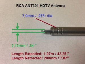

Just and FYI with looking for replacement antennas. These need to be 7mm in diameter so they are contained by the holding features on the rear housing of the radio. I found an additional antenna, that can easily be used as a replacement on the RC-M70. Have a search on E-Bay for the RCA ANT301 HDTV antenna. This is an indoor antenna that can supply you with a matching pair of antennas very close to the originals. Note there are two types of ANT301, one with shiny and another with silver-matte finish telescopic antennas. I have the matte finish version.
Ca880

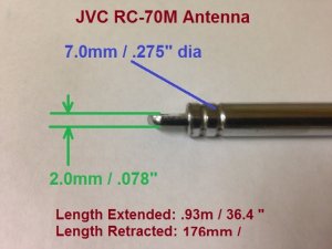

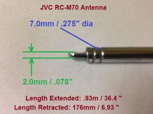

Here are the dimensions of the two types of antenna: JVC original and the RCA ANT301

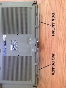

Here is how the two look on the back of my RC-M70:
