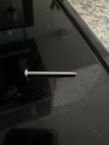

Bill, I looked back at this thread and did another round of searches for M4 "plastic thread" screws. The thing that makes these so hard to find in the correct diameter and thread style is their long length. The closest match I could find was at McMaster, they are 10mm shorter, but you'll still have 60% of the threads available, possibly more if the threadless upper half of the original screws goes into the boss. They also have a slightly different pitch (1.79 vs. the original 1.65mm) but Ingolf used 1.75 and they worked great for Joe. Bag of 10 for $6.50.

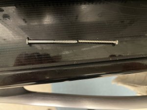

So I got the screws but they were to small compared to original. Not the length but the actual width was to narrow. Oh well hopefully Ingolf can come through for me. Thank you for trying Eric!!!Actually I was waiting for you to try out the one I sent you, no rush though.
I can actually see the difference between the 2 screws and these are a bit narrower than the original. I will try and get some picsThat's strange because the originals are M4 (4mm) screws, so the ones you purchased should be the same. When I measure mine with a caliper they actually measure a little less, at 3.95mm. I wonder if your plastic is stripped a little.
Thank you for the information. I did purchase some screws from Home Depot that actually are really close to oem ones and just had to trim off tip but work great!!!Just throwing this out there.
