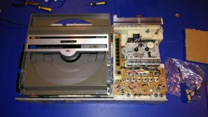

Got some assembly done with cassette and turntable back in. Nothing powered up yet but watch this space.
