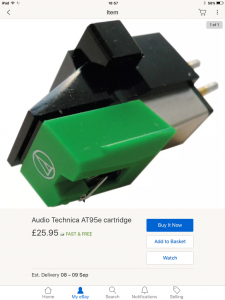

I have a sharp vz2500 and the A side plays out of one speaker channel. While B side works fine.
So I am looking now to change the cartridge. I've been looking on eBay. At this.
Can take the cartridge out of this black housing and and fit to sharp housing.
