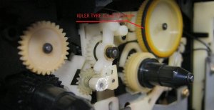

I found solution for this issue. I change the idler wheel tire and full auto stop function starts working again.

Kust sa neid idler wheeli kummist rõngaid veel saad ? :w00t:
crazygamer
Kriim said:
Selline firma nagu VARSON OÜ oli abiks. Nende kaudu ostsin 2tk/1€.
