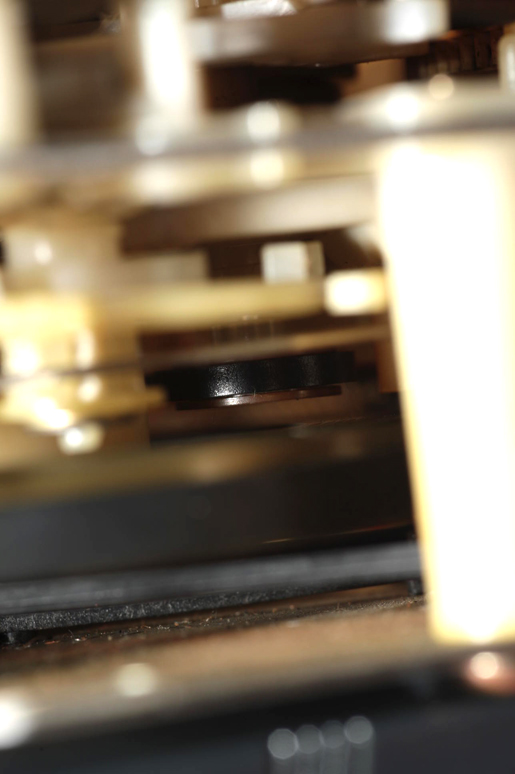

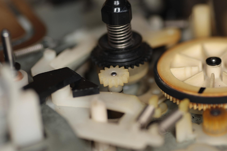

a couple of shots if anyone need reference, the rubber is on the opposite end of the small cog on the photo.....you don't have to strip the deck to swap the pinch roller or clean the rubber rings, just undo the two screw that hold the operating switches onto the base on the left of the pinch roller. Oh and be careful how the springs come off, remember which way the small one goes back on. the second photo shows the rubber ring that needs to be cleaned...there are two.....the other takes some finding, I just couldnt photograph it....to difficult but I managed to get to with a cotton bud, you have to put a tape in and set it going in FF or you cant clean it.
