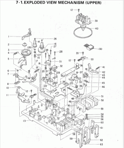

I am working on this monster now and would like to share some information with you guys, Hope it helps.
This units has 2 decks , each dech require 2 belts, They are FBS 10.0-10.2 , SCQ5.1

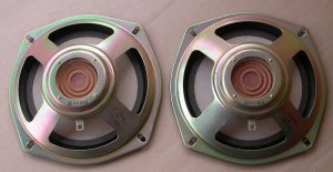

Update: Deck A , Deck B service complete.
I will dump those 2 passive radiator . And switch them o AIWA 160mm ( made by Panasonic) woofers.

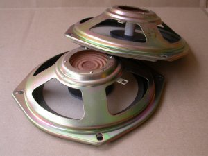

What are the original passives made of? Plastic, paper, or.....?
Would be nice to re-whiten them somehow.

frank are they the same size as the 880 passive radiator, i can't remember, if so i would like to buy them from you

White looks awesome, if it's true white, not that faded brown. Why not bleach them or paint them white, and then re-do the "Toshiba" label if you need to?

Those are good passives by the way, they have a spider suspension behind them, unlike the Aiwa passive which has nothing behind it.

Correction:
Belt size
Deck A : p/n 25755527 PRB FRW9.2 (main belt)
p/n 25755528 PRB SCQ 5.3 ( Belt,Center pully)
Deck B : same as deck A but add a counter belt, which Toshiba part number is 25755529 . PRB SCY 7.0
