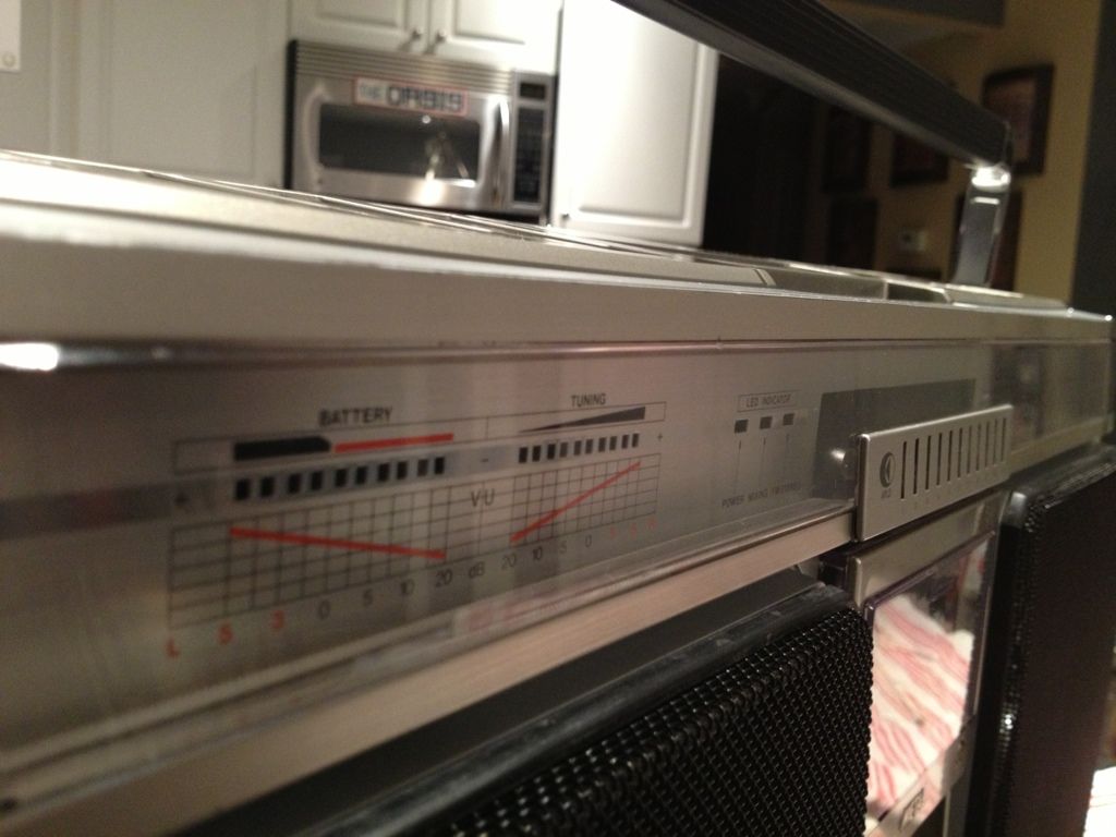

I have never removed a tuner glass except from a parts box i found ....but on the removal i cracked the casing but was sucessful on removing the glass...however on all of my restorations i usually am able to polish them out using an automobile varible speed polisher/sander...I tape off the area's on the box not to burn the paint on the cassing ....I begin with a microfinish compound with a white wool cutting pad this usually removes all the imperfections and gives me a smooth surface :thumbsup: after this step i use a finishing pad with finess it ...this is a liquid that is manufactued by 3m...after i use a good automotive canubra wax or meguires plastic x...my results using this process have been spectacular...just trying to say this could be a possible alternative to removing the tuner glass...here is a pic of my methods results :thumbsup:
kraftmatic
Wow, that's amazing work! I had no idea that you could restore glass to such condition. I'm going to have to try your method on a few of my units. Thanks for the info! :thumbsup: :thumbsup:

I have never removed a tuner glass except from a parts box i found ....but on the removal i cracked the casing but was sucessful on removing the glass...however on all of my restorations i usually am able to polish them out using an automobile varible speed polisher/sander...I tape off the area's on the box not to burn the paint on the cassing ....I begin with a microfinish compound with a white wool cutting pad this usually removes all the imperfections and gives me a smooth surface :thumbsup: after this step i use a finishing pad with finess it ...this is a liquid that is manufactued by 3m...after i use a good automotive canubra wax or meguires plastic x...my results using this process have been spectacular...just trying to say this could be a possible alternative to removing the tuner glass...here is a pic of my methods results :thumbsup: [ Image ] [ Image ]
Wow!! Great results, i've seen it done by someone using something like a "dremel" tool. Doing complete replacements are last option i think...
