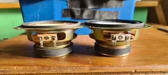

I found a great match for the drivers on a JVC PC-5. I saw a pair of Panasonic SB PM10 bookshelf speakers for £25. So I took a chance.
The drivers from the JVC are 25watts and measure at 7ohms.
The Panasonics rate at 20watts and measure 8ohms. Not perfect, but the look is good.
A quick comparison for size shows they pretty much the same.
So close
Two slight modifications I had to make were:
1. The the black support ring around the edge was 1mm thicker on the panasonics. So I shaved it down to allow the grills to sit down flat.
2. I took 2mm off the edges of the chassis and put slots either side to allow the surround to locate.
Almost indistinguishable

looking really good !
for great sound (bass all the way through clear highs) I discovered Fostexes (whiitish ones) do a really great job on pc-5 speaker boxes, they look decent too. A bit expensive but well worth it concidering the sound on a pc-5. But esthethically your option is fantastic !
