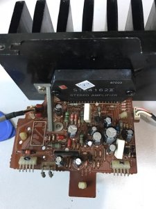

Hi guys, can anyone help me, I need to know the correct model of the RY601 relay that goes on the Power Amp Board, so I can do the replacement. I want to know what voltage it works.

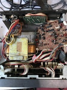

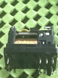

I need to relay to replace!!

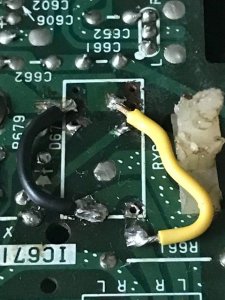

I would bypass the relay to check if there is some else damaged in the protection circuit. Why do you think there is a problem with this contactor?
Is there any way I can isolate the relay and the circuit will work ??
I bought this used sound .. I was able to recover the audio card and the relay is all damaged ..
If you put jumper wires on the circuit board that connect the circuits directly from point a to point b that should power up on the unit.
rasec72
Correct friend and thanks for the tip !!!
