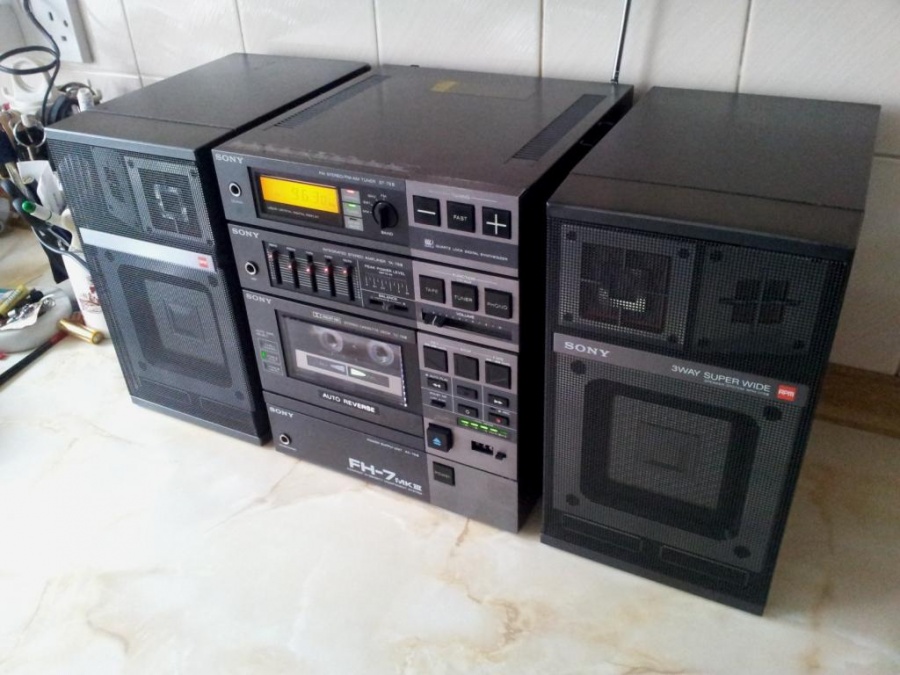

This arrived on Friday, re-belted the deck, replaced the tuner display lamp, gave it a good clean and dismantled the speakers and washed all the dust out of the fronts. Has some wear and tear, but still looks nice, just needs a handle, anyone?

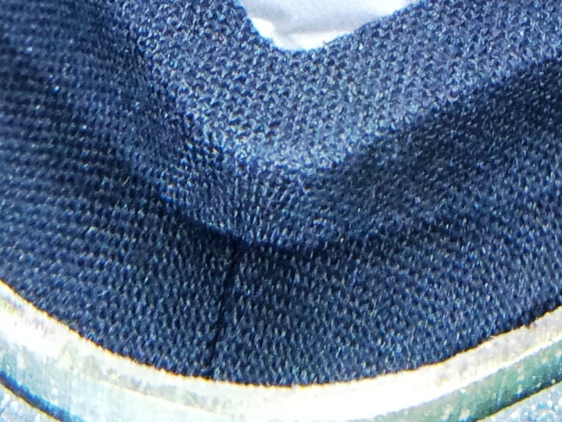

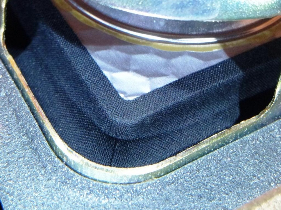

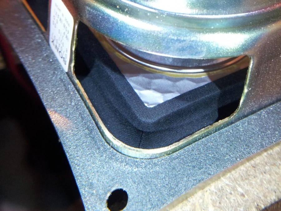

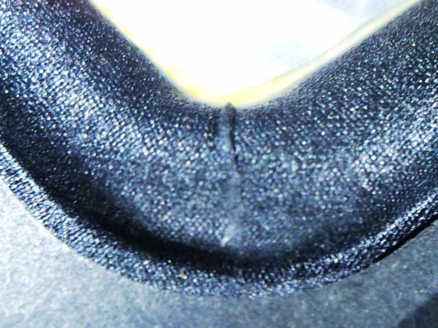

Okay had a good look at the APM woofers I hate to disagree but the surrounds look like fabric to me, here are some close-up pictures.
The frontside is treated the rear is bare.
That is good news! :yes: :yes:
So, they made better speakers later on seeing the issues with the foam types.

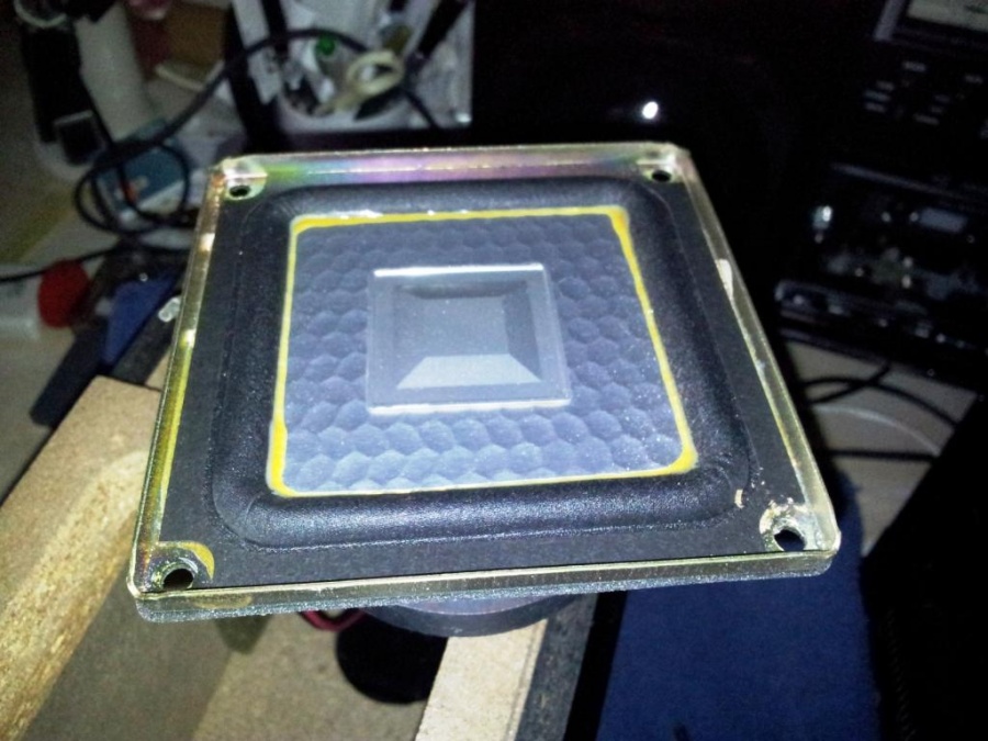

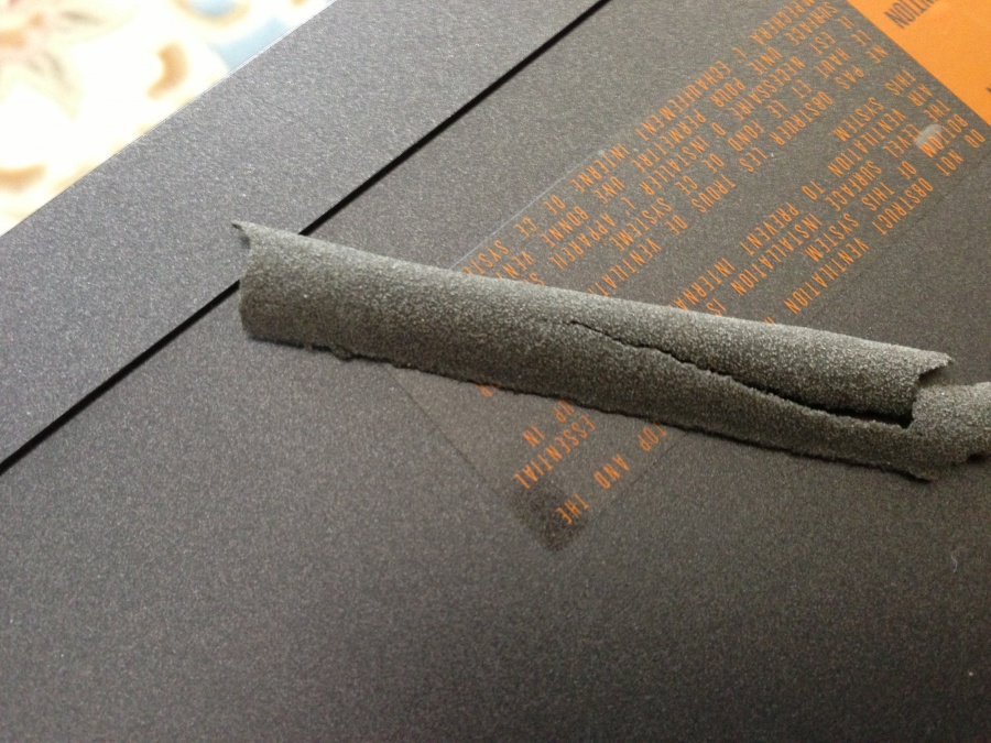

See how mine looked...

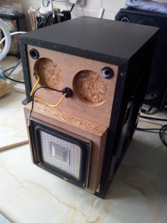

I have to use Freddie's Method to make the surrounds. Now the speaker is out for the job. I am cleaning up the sticky mess it left on the sides and the edges of cone. :yes: :yes:
First I need to make a perfect mold to make the surrounds. :huh: :hmmm: :hmmm:
Any misalignment would make the voice coil rub against the magnet and kill it. . The plane of cone edges are almost 5 mm behind the plane of speaker chassis rims. Very tricky when I glue it all together. I still got steady hands even after years of bourbon, vodka and beer abuse :drunk: . :lol: :w00t: :w00t:
This is no easy job as it looks :sadno: :sadno:
I still cannot believe they made foam surrounds....

Thanks Freddie! :yes: :yes: If you bend the cone a little the voice coil will rub on the magnet. Fixing is not easy as it looks.
