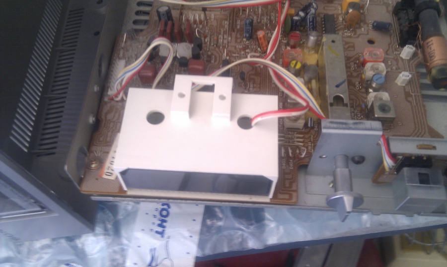

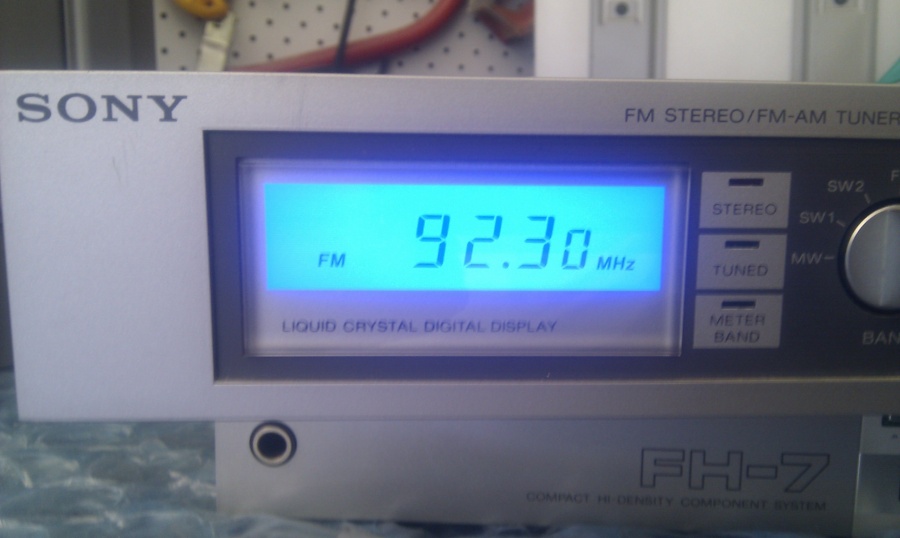

The tuner light was blown in my FH-7, I had a spare blue 3 LED light strip from when I did my M70 tuner light mod so decided to see what it looked like.

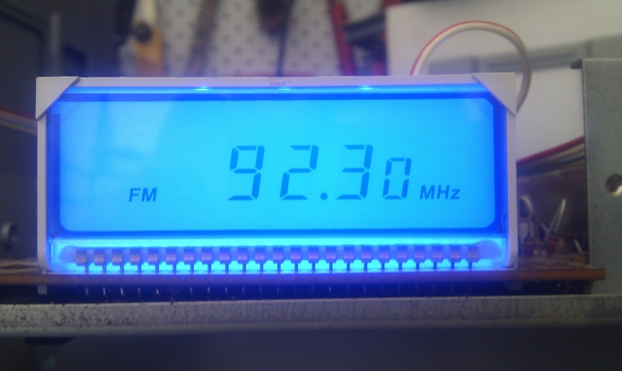

I'm happy with the results, it looks a little bright in these pics but it isn't in the flesh.

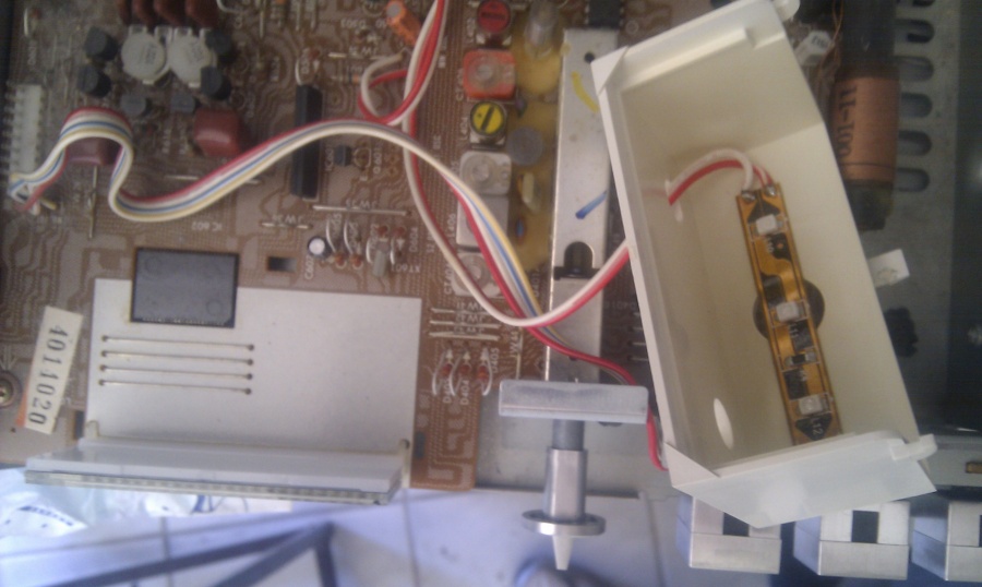

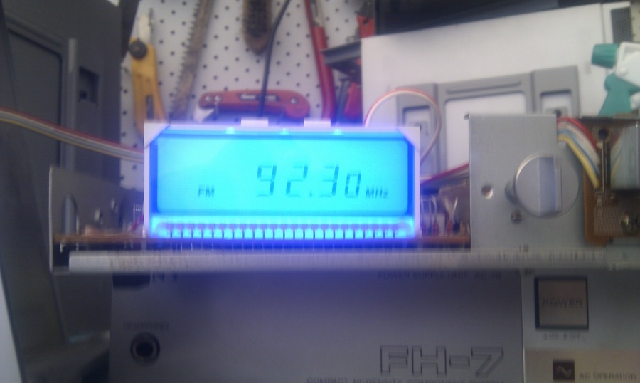

I just removed the little circuit board that had the single bulb, soldered the old light wires to this strip, the voltage was 12 volts and this strip already has resistors built in, I then put the LED strip in through the top hole in the light bracket stuck it down using the adhesive strip on the LED strip and put it back together.
