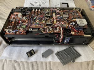

I took apart the sony (very precise mechanism) as well as my akai GXC-750D.
but fortunately i had the manual service (original paper) because the scans on the web are not accurate enough.

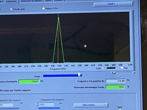

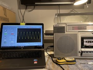

I changed all the belts, greased the mechanics, lubricated the sliders and all the switches
then, adjustments: speed, play, dolby, S&f, demagnetization, rec etc...
to finish, degrease the box and disinfect (covid)
and well, I launch the first cassette, and really a lot of happiness!
Certainly it is not! the big song very heavy in bass (jvc rcm: 70/90)
but an exelent quality in cassette playback: type-2, with or without dolby.
I tried the recording of course and again, great!
ok it`s not my tc-k 777es, but very good balance on tape 2.

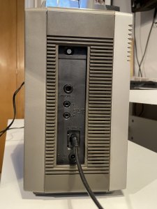

pap

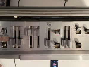

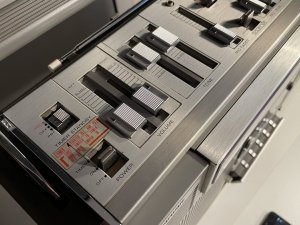

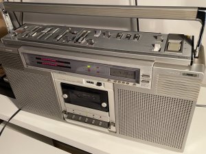

photos
Hisrudeness
Good that it’s working again.
Agrred, not a powerhouse but an interesting box with some nice design quirks. Oh and definitely well built.
