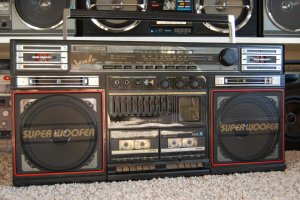

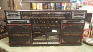

The Lasonic TRC-951
Minimal chrome, blacked out speakers with black dust covers and few red accents.

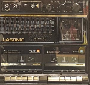

When the 951 came to me back in 2012 it wasn't in bad shape, but not really in a "Usable State". The tuner does not work. Decks are farked, the EQ was missing 4 sliders. BUT THE LINE IN WORKS!

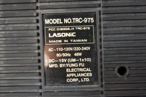

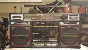

Hitting the street....need flash and flare :huh: TRC-935 ! ! ! :w00t:
Going to beat swap in Los Angeles with SLO, Fresh Produce and Mac Daddy Freshness :huh: TRC-975 ! ! ! :w00t:
With the EQ sliders busted out, no FM and no decks.... :-/ She has been over looked more times than I can count.
Today, that comes to an end! :annoyed:

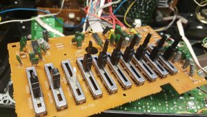

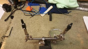

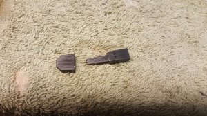

First off, we have to deal with those EQ sliders!
Can't be walking around missing those!
All the EQ pieces were in the battery compartment, right were blu_fuz had put them when he sent me the radio back in 2012

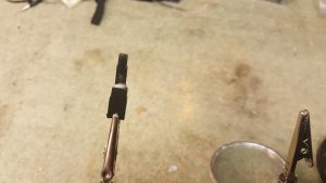

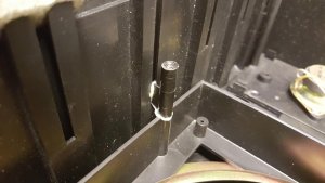

mellymelsr suggested Devcon Plastic Weld to make repairs and the stuff works great, best I have found so far.
I had to make a few extension pieces and glue them together
I also used the plastic weld on some screw posts, worked great

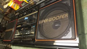

While the plastic weld dried (1 hour) I broke out the Wizards wax and went about giving the old 951 a polishing.

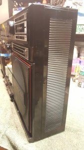

After working on the 931 and polishing that to a perfect shine, I was looking at both the 975 and 951. I thought they were both a flat matt finish. As it turns out, the 951 is oxidized. A little elbow grease and all the surfaces polished up to a nice shine. This radio has never had the full tear down. So at some point, I'm going to pull it down to nothing and when I do, I'm going to machine polish all the scratches out of the top, like the 931.

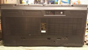

So, last night while cleaning and polishing, I wiped the edges of the two halves, front and back. Both were dirty and crusty. When I took it into the garage to work on it, I noticed it had the typical creaky sound most of these big black radios have. The handle creaks, the case creaks. In the past, like on my Dynasty HT-959 and Helix HX-4700, I put a lot of effort sealing the edges with synthetic suede. It keeps the two halves from actually touching and therefore eliminating the CREAK.
But last night I wiped down the meeting surfaces with a clean damp cloth, then waxed the edges just as with the rest of the radio and you know what? NO MORE CREAKS! Cleaning the meeting surfaces and waxing them prevents the two plastic halves from GRINDING on one another and making that horrible cheap sound. I took the radio out this morning to take pictures and it's tight as a drum (especially since I fixed two screw posts). No creaks in the case or handle (handle got waxed too).
SO THERE YOU GO! A simple, easy way to fix case creak! WAX ON, WAX OFF DANIEL SON!

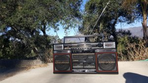

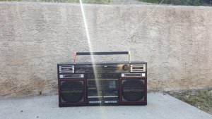

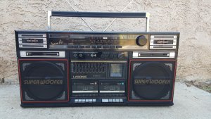

She looks good outside!
Hisrudeness
13 years in this hobby and still no Lasonics.......wait! Did I say that somewhere else? Never mind.
Great box Chris, I didn't even know about this one. Have you got any pics of her lit up?

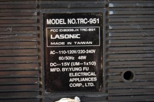

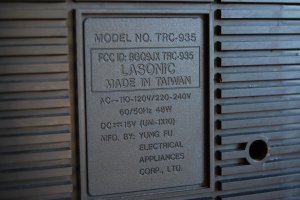

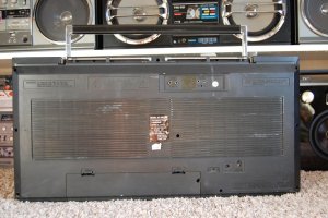

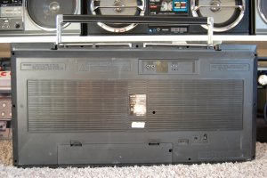

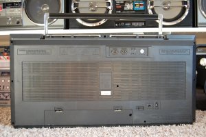

The 935, 951, and 975 are all the same size and all use the 935 case. The rear cover of the case model number is molded into the plastic as the 935. They just put a sticker over the mold to label the 951 and 975.
I am 99% sure the main/tuner board is interchangeable with the 975, so if Chris runs across a parts unit he could probably get that fired back up.

OK, spoke to Dr DER, he has a 935 main board with tuner I'm going to try. It will upgrade it from just a line in box to line in/out IF the transplant works!
Van Presence
ah i noticed that. the 935 has line in/phono and line out but the others no line out. kinda strange
trippy1313 said:
What?!? The 975 and 951 don't have Line-Out???
Yep, Lasonic saving money again....The only time I use the line in line out is when I am daisy chaining the boxes together, which I have done. We'll see if this works.
