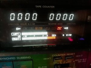

Hello guys. I had a used Aiwa WX 808 in a good bargain a few days ago. It looks awesome. Its almost brand new and as the previous owner stated it was less used. It sounds good but in the VU meters I can notice the left channel is a bit weaker. Even using input on pc audacity's VU meter looks a bit quiet on left side. I have checked the service manual and I have seen tons of adjustment switches. PB Frequensy response adjustment, PB senssitivity adjustment, Bias OSC frequensy adjustment. Bias OSC coil Adjustment. Rec equalizer level adjustment. Am kinda new in tape deck world, so I have no idea which one of these adjustments helps on balancing general volume left channel. Any help?
Anyway here is the image!

Yeah loving it already! Well about the playback, its not possible due to faulty belts. I will replace those within this week. There is no record/playback bar as the whole machine is electronically controled. All I can do is to clean out the record input control switch. About Adjusting the pots, which pot do I need to adjust exactly. There are tons of pots. I only need to adjust the one for the recording levels.
Guys you wont even believe how easy it was. On the rec input switch, there was 2 controls instead of one! So now I have beautiful clear stereo sound
