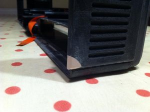

So I picked up this wreck of a Sharp GF9191XE with the plan to see what I can do with the wreckage...its all semi-working but its a mess with cracks, bits missing, posts broken, tape door hinges bust etc...just how I love em :w00t:
So this is this thread is part 1 which is just the back casing
From the front it doesn't look too bad
The only part rattling around the bottom of the box was the missing aerial clip so that was handy!...have built up the missing pieces with various bits of plastic sculpted to shape using the good old dremel tool, then car bodywork filler, losts of sanding, then a full repsray.
It was pretty tricky as the biggest missing parts were the indented bit and the bit around the aeriel clip...took some working out that did! Had to rebuild several of the lugs and strips around the edge that hold the front casing in place too...it'd clearly had a bit of a fall lol
I've not aimed for perfection as its only the back of the box and its taken a lot of hours to get here.
Pretty pleased with the outcome...definitely a bit more presentable than how it was at the beginning! Now to start on the front!!
Anyway these are the pics in the right order :-D

Cheers matey...I just like a challenge lol...its actually more work than it looks too...the aerial clip will take some forces on it when you clip the aerial in and out so I've had to cut plastic in layers that slot in giving as much contact area for the glue as possible...there are probably 8 or 9 separate pieces around the aerial clip alone but its as strong as an ox now
