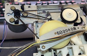

I have a Sharp GF-A1 and a Sharp GF-A2. They both had worn and broken belts so I couldn't see how the belts went on. It seemed pretty obvious as the motor has a double slot spindle (see attached pic) so it seemed like one belt would go on one obvious wheel and one on the other obvious wheel (see attached pic). I tried this and the REW worked fine, but PLAY and FF moved really slowly.

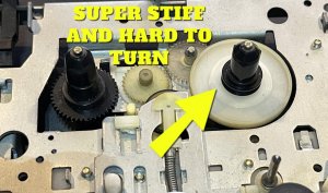

NOW...when trying to turn the right hand cassette spindle by hand....it's SUPER stiff....really hard to turn. But the left spindle (REW) turns freely and easily. Does the right spindle have a braking mechanism?
The weird thing is that it's the exact same on both units. This seems like there must be something I am not understanding about how these work because that's astronomically improbable. I must be doing something wrong.

To test if it's a brake issue, you can manually push the carriage up that the heads are on.
That should release any brake and you can try turning the play/ff spindle.
Sometimes the belt pulleys move when going into certain modes.
It's possible these pulleys move and your belts are too tight.
I've never had either of these so it's just a guess on my part.

[SOLVED]
Turns out the astronomical impossibility WAS what was wrong, they both had a gear that had dried up and needed oil. Everything turns FREELY now.
