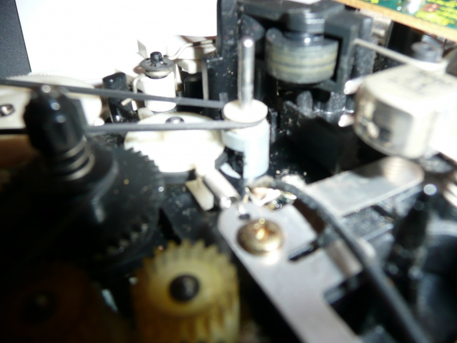

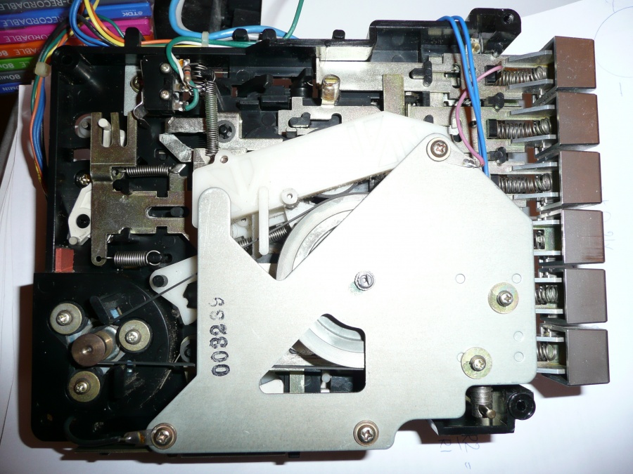

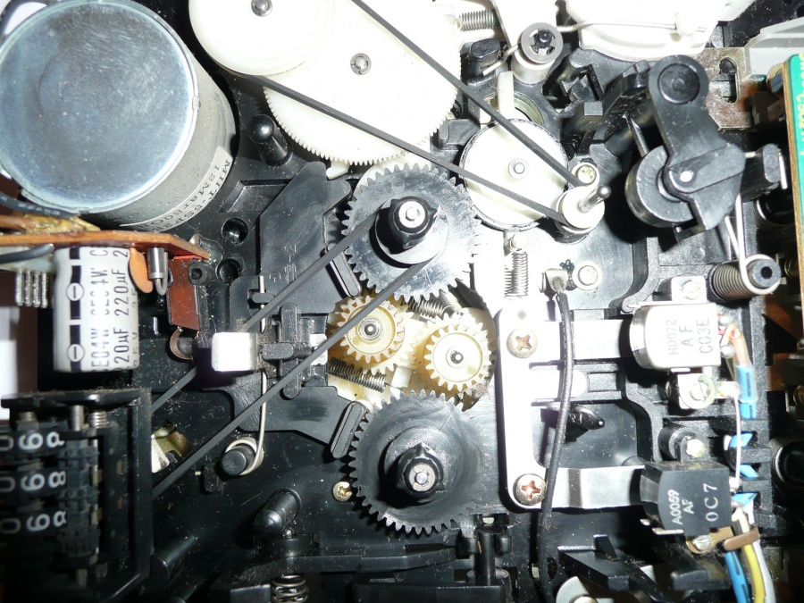

I've opened the 9494 up again, and the idler had quite a bit of goo on it. As per Superduper's recommended first step, I have cleaned it with some buds and alcohol. It looks better. Now, that silicon tube bit.......do I need to get to it (err....remove it) from this side?
......or this side? It looks like it is underneath where the flywheel is, so I guess it's surgery. :hmmm:
What did you do Alfie? Saxonman? Superduper? Anyone?
Look forward to your thoughts.
Cheers
Brownlow

You're gonna have to take off that back plate to get in there. At least one of the screws is spring mounted (this is important for when you put it back together), if you check the thread I refered you to it should help because I had issues with the spring mounting. Once you have the back plate off you need to pull off the main wheel to replace the gooed piece of rubber. Make sure you replace the belts while you're at it or :superduper: will give you into trouble ;-) .
It's a bit of a fiddle trying to get the new silicon tubing on there, you may have to cut it a few times to get the right size but be patient, you'll get there,
GOOD LUCK!!!!!!!!!!!!!!
Chris. Remove the backing plate that secures the flywheel. The flywheel pulls straight out and along with it, the capstan needle will pull out too. Once the needle is completely outta there, you can then really get in there with the alcohol. There is no way to install the silicone tubing without removing the flywheel and needle. Once it's all clean, you stick the length of tubing into that chamber where the old pulley was and thread the needle back through there, and through the tubing.
