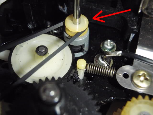

Hello everybody, I have a Sharp GF 9292 in process of restoration. I am replacing the rubber bands and there is only one piece left : a little piece that goes in the capstan shaft tyre that is deficient. It goes inside a small window.
I´ve already replaced it in my GF-6060 but the GF 9292 is different : the capstan has a little plastic wheel attached and here it goes my question : does anybody know how to remove that wheel in order to remove the capstan? (see picture)
I´m afraid that if I do the wrong procedure the plastic wheel can break.
Thank you very much in advance
Regards
Yep, it slides right off the shaft. It will have a tight fit though. Also, there might be a small, metal washer underneath - don't lose it. :-)
